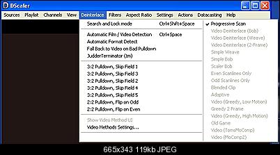

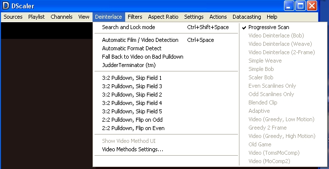

    Should I be able to CAPTURE in Color space : YUV ?
    I re-captured (with DScaler) and turned EVERYTHING off. All interlacing, deinterlacing-type of filters OFF

    and selected Video(greedy low motion)

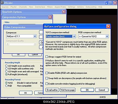

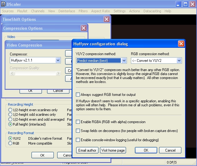

    Here are the compression settings:
Name:	descaler compression option.jpg

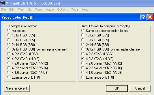

    After capture....the video shows up in Virtualdub as RGB. I changed the input and output to this:
Name:	VDub color depth.jpg
    ....did my 10 second sample....and that is my MediaInfo text above.
