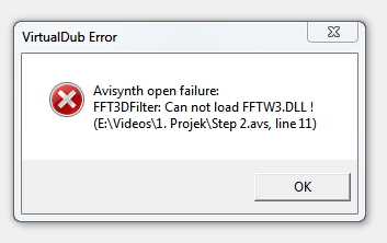

    I am struggling to install the fft3w.dll. Apparently one needs to paste it in the system32 folder within the Windows folder, then "run" and insert regsvr32 fft3w.dll and then OK. It does not work. This dll file is also in my Avisynth plugins folder.
    Can you help please?
    Image Attached Images
  11. Banned
    New York, US
    If you are running the 64-bit version of Windows, put FFTW3.dll in your Windows\SysWoW64 folder. Don't place a copy in System32.
