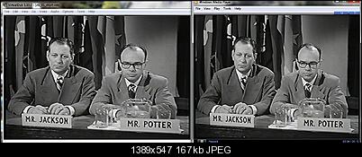

    Okay, after more research, I'm posting a short video in VOB format ripped from the first one of the DVD. I am also posting an image of Media Player and Virtualdub simultaneously. Virtualdub shows what my TV shows and Media player shows correct??
Name:	ScreenHunter_04 May. 08 21.18.jpg
    This is the short video, it is 12mb but resides on GoDaddy so shouldn't take long to download and is only 30 seconds. I ripped directly from the vob so no recoding occurred:

    I changed the Pan & Scan and letter boxing DUE to this problem. My TV shows incorrectly with and without these options. Also VirtualDub and Media Players show differently as well. This is what has originally puzzled me.
    Last edited by Budman1; 8th May 2013 at 21:38. Reason: Response to unupdated response
    [Attachment 17726 - Click to enlarge]
    Well....not quite. VirtualDub is displaying your frame at its encoded frame size, which is what VirtualDub does by default when you open it but don't tell it to display otherwise. The frame shown in VirtualDub isn't 16x9. It's 720-x480 -- your video's encoded frame size, which is an aspect ration of 1:5:1 ( or 0.66666666666:1 if you really dig decimals). Your TV doesn't have a 1.5:1 display. Its display is 16x9, as you know, or 1.77777777777778:1.
    But you probably know all that. In case it's unclear, do this in VirtualDub:
    - With a video open, right-click directly on the image. Not on a menu or other area, but on the image itself.
    - On the right-click, you'll get a popup menu.
    - On the left of the popup menu are reduce/zoom sizes.
    - On the right side of the menu are aspect ratios.
    - Scroll down the list of aspect ratios and left click on "4:3 (TV)"
    - Voila.
    But if you already know that, then let's go to your TV. The three image size controls you mentioned earlier are those found on your TV remote. I'll bet if you point your Tv remote at the TV and click the TV's "Menu", you'll find an icon or menu item, somewhere in the thousands of menus that controls "Screen" or "Display". Therein you'll find controls for controlling overscan on/off or pixel amount, Auto-Full on/off, Auto Letterbox on/off, etc., etc., and 4:3 display defaults, and lots of other stuff.
    Or go into your DVD player menu and find something that let's you control the TV display size (4:3, 4:3 Letterbox, 16x9, etc.).
    Thanks for the sample. It's 4:3 and it plays that way on everything I throw it at. Or, "it plays that way on everything at which I throw it."

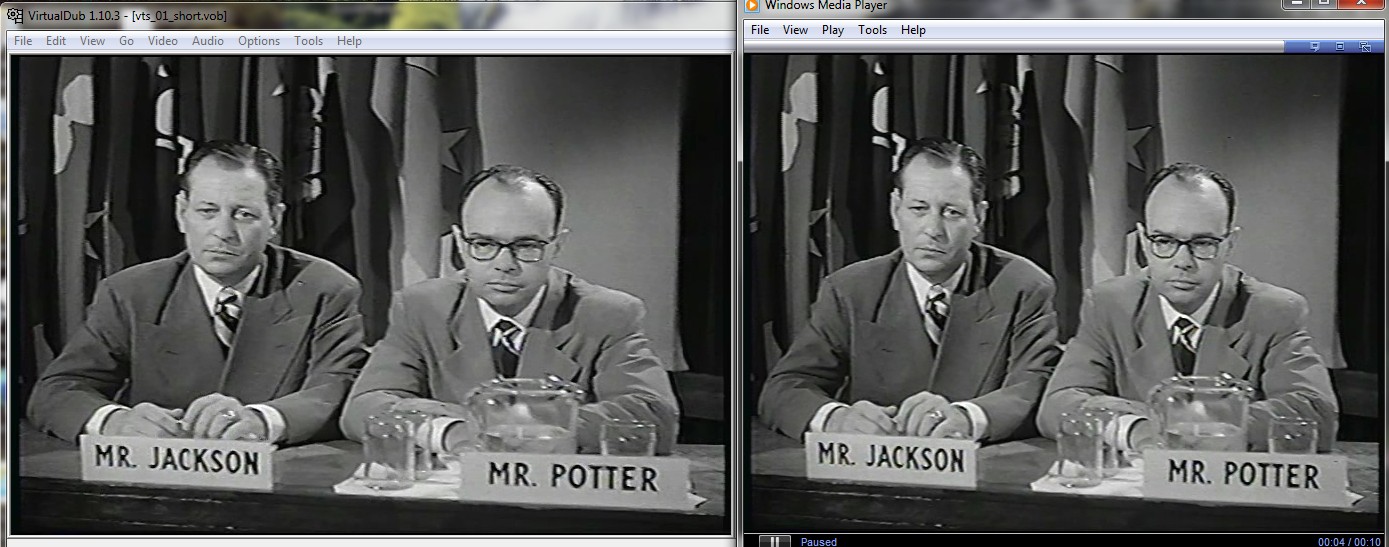

  12. It's one thing for a VOB to be 4:3, which this is, but most (but not all) players get the DAR from the IFOs and not the VOBs. Below is a picture of what it would look like if it were really 16:9, wider than your picture on the left above. Maybe there's some odd picture extension that was added to it. Or maybe it's being played as 1:1 (720x480).
    Again, make sure both your DVD player and your TV are set up correctly. I have no idea what AVS4YOU is, but there's at least one other glaring error in that DVD. You managed to encode it as progressive 29.97fps. That's something that should never be done with film sources. In every five-frame cycle there's a duplicate frame..
