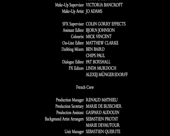

  9. That's a tough video. About the best I could come up with was something like:
    AssumeTFF()
    QTGMC()
    SelectEven()
    ColorYUV(gamma_y=600, off_y=-40) # brighten dark pixels
    Sharpen(0.5,1.0)
    Blur(1.0,0.5)
    ColorYUV(gain_y=-30)
    You can try playing around with the values to get it more to your liking. Instead of QTGMC().SelectEven() your shifted field technique might work better or worse.
