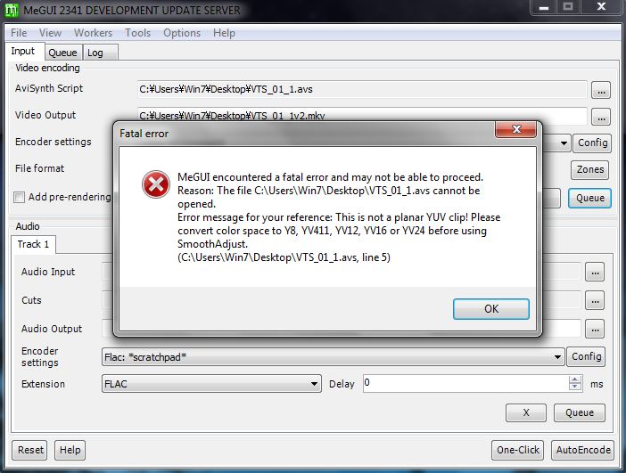

  21. I tried using that script to encode the video from MPEG to AVC in MeGUI but it says "Script error: Invalid arguments to functions SmoothLevels line 3", so I tried creating a new avs file using the MeGUI avs script creator and writing the new lines manually, and this time it said this:
    Always using VTS_01_1.MPG.
    This is the full avs script (generated with MeGUI and modified after):
    LoadPlugin("C:\MeGUI\tools\avs\directshowsource.dll")
    LoadPlugin("C:\AviSynth 2.5\plugins\SmoothAdjust.dll")
    DirectShowSource("C:\Users\Win7\Desktop\VTS_01_1.MPG", fps=23.976, audio=false, convertfps=true).AssumeFPS(24000,1001)
    SmoothLevels(1, 0.78, 255, 14, 230,chroma=200,limiter=2,tvrange=true,smooth=100,\
       dither=100,lmode=2,darkSTR=10)
    SmoothTweak(saturation=1.15)
    ColorYUV(off_y=2)
    #deinterlace
    #crop
    #resize
    #denoise
    I'm probably doing it the wrong way, is it missing some basic plugin?

    No, it's just the way VLC plays some videos. I have occasional problems with it. Using MPC-BE most of the time now. When I laod the clips in VirtualDub I don't see banding either, I have to look for it.
    The error shown is a colorspace message. SmoothAdjust wants YV12 only. Your MPG should be YV12 already, so I don;t know what's going on there. You might have the wrong masktools loaded. I'm using mt_masktools-26.dll. As it is, you'll need that version anyway as you'lll see in the script I'm posting soon. I have an earlier masktools in my plugins folder, but the '26' version is in a separate folder and I load that separately with LoadPlugin because I'm using both versions of masktools for different plugins.
    Back in a short while.
