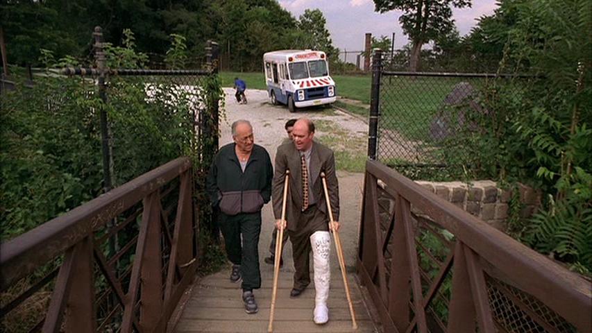

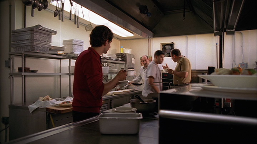

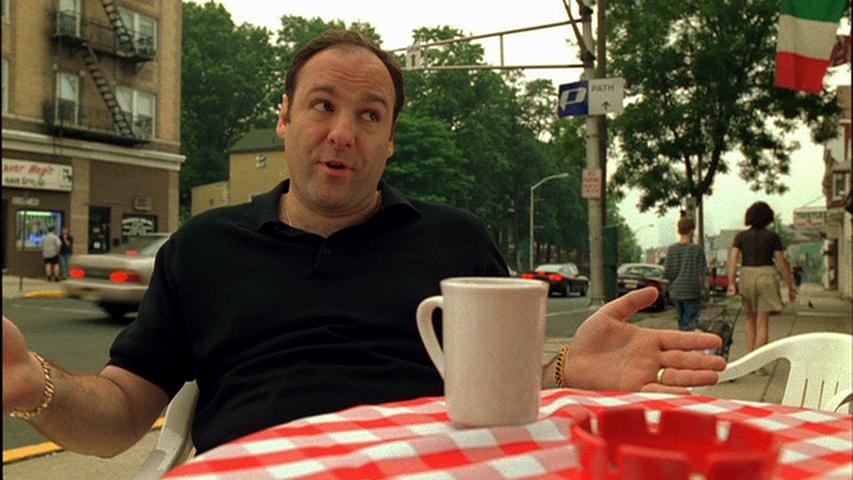

Here are some screen caps but the true test is when you watch the videos. I'm torn between the CCE and HE encodes. The CCE encode looks a bit grainy while the HE encode looks a bit lighter and softer than the original. Not sure which one I'm going to use. The DVD-Cloner encode is OUT as far as I'm concerned. The DVD-Cloner encodes look like they are missing frames because the video looks slightly "jerky".
Are there any tweaks that will make the CEE encodes slightly less grainy without softening the video too much? Or is there a way to sharpen the HE encode without making them grainy?
I would appreciate feedback on which screen cap number (i.e., 2, 3, 4) you consider the overall best. I'll post which number belongs to which encoder once a couple of replies are posted. All of the number 2 pics are from the same encoder, all of the number 3 pics are from the same encoder and so on...
1 (source):
2:
3:
4:
1 (source):
2:
3:
4:
1 (source):
2:
3:
4:
