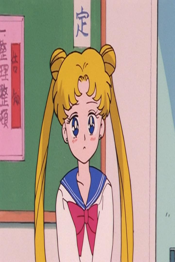

  5. Never mind, I accidentally messed up the resize and didn't notice. Thanks for the help though.

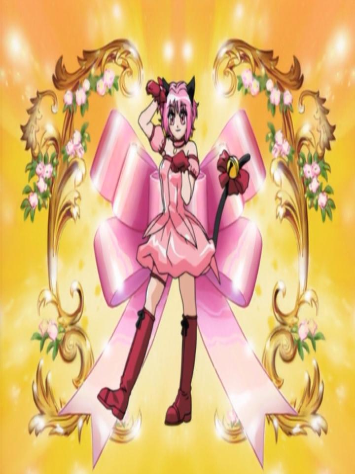

  6. So I'm having the same problem, but with a different video. Anyone know what is happening?
Name:	Tokyo Mew Mew Script_mt.mkv_snapshot_00.00_[2013.05.12_22.26.52].jpg
  7. its suppose to be 720,480 idk why it keeps coming out like this.

  13. This is my log file. Sometimes the aspect ratio will come up like the image up top, while at other times when it gets to the second pass it closes the encoding window and says error under the status tab.
  14. wxh where as w>h in your case w<h.
  15. I'm a little stupid so can you explain to me what that means. lol srry.
  16. Originally Posted by beav View Post
    wxh means Width x Height.
    The width should be greater than the height, but in your case width is less than the height.
    Swap the width and height values around.
  17. no but the problem I'm having is that my files keep coming out the wrong width and height. I have megui set to 4:3 and my script has the resize set to 720 x 540.
    Spline36Resize(720,540) #spline (neutral)
