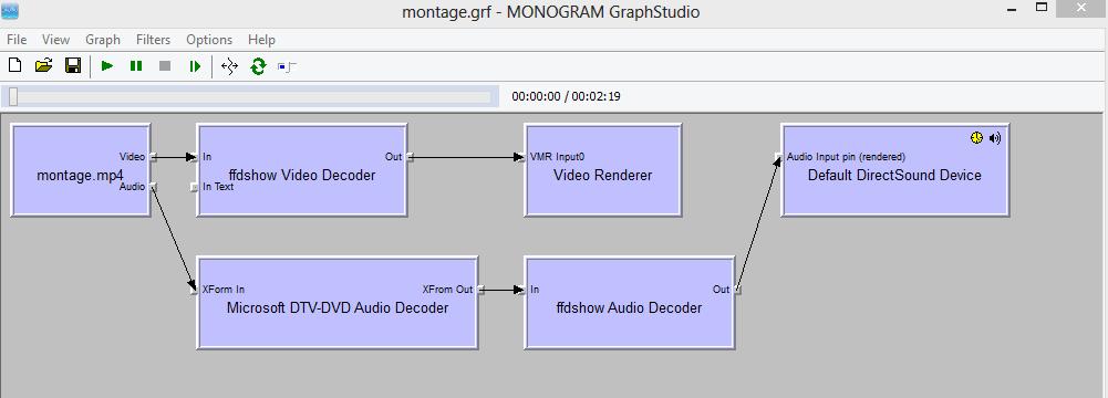

  4. The source mkv seems quite "normal" both the video and audio streams. W/o a sample it is hard to replicate the issue and understand what's going on.
    If you load the mkv directly in AVStoDVD and select 'Codecs'/'Build DirectShow Filters graph', what is the resulting filters graph? Report here the image.

    here it is

  6. There is a redundancy in the audio decoding path.
    Download Win7DSFilterTweaker, install it, select ffdshow as audio AAC preferred direcshow decoder.
    Bye
    thanks that worked!!!
