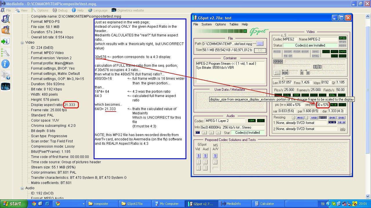

  6. This is my first message here, excuse me if i'm doing something wrong...
    and excuse me for my bad English...
    I've had the same situation before and found a detailed explanation in this page;
    http://www.dvmp.co.uk/mod-video-file-format.htm
    just as jagabo said
    And found the reason of the mismatched Aspect Ratio information reported by Mediainfo...
    Seems the mpg2 encoder causing this (for my problem)
    I dont know why the "portion" is not taken as the FULL frame (480x576)
    Below is the screenshot of my situation...
Name:	SEQ Portion Display Ratio.JPG
