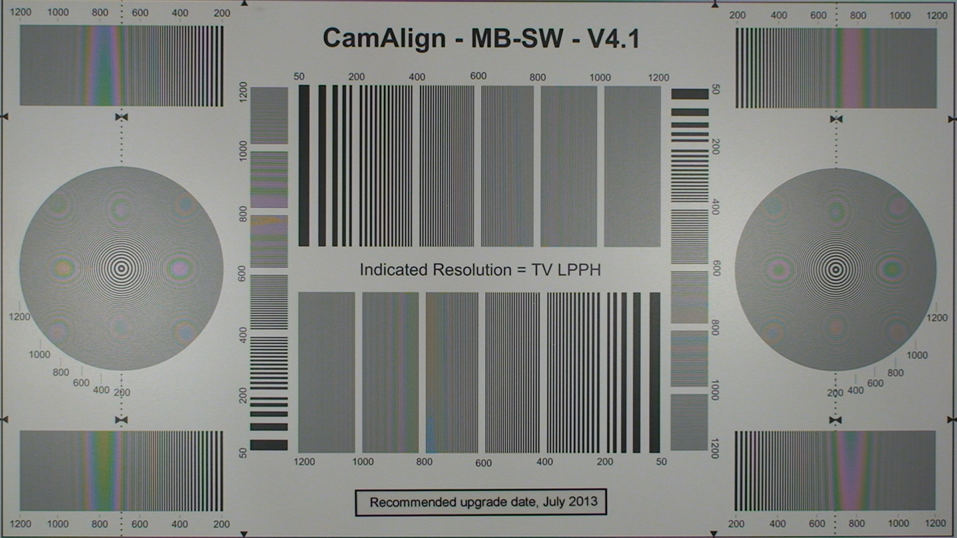

    Again: video quality means fine details shaprness , the real video-resolution (instead of the advertsed kontainer resolution)
    A very good consumer camcorder can produce and reach 1100 * 1100 LW/PH real resultion in the 1920*1080 (Full HD) pixel container fromat, while a good digital camera can produce and reach only 600 x 600 or 700 x 600 LW/PH REAL resolution in its 1920*1080 container format... The result: more blury less sharpness and less fine details on the video image...
    LW/PH means real resolution: widths per picture height
    TEST CHART FOR REAL (VISIBLE) VIDEO RESOLUTION:
