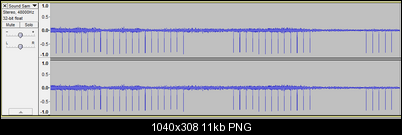

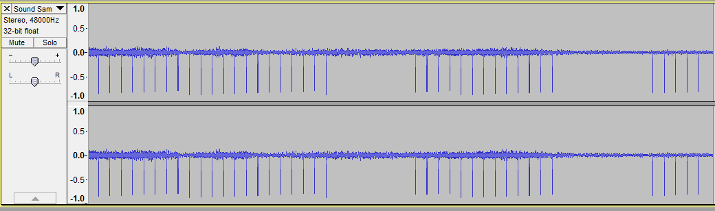

    Something's wrong with your tablet! There are obvious big clicks at ~1/20 second intervals:
    I don' t know what the cause is but Audacity's click removal filter can get rid of them. Sample attached. I don't know if that other bit of static near the end of the clip is related.

  4. Originally Posted by jagabo View Post
    [Attachment 17632 - Click to enlarge]
