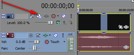

    i think what you want to do is use the track motion effect. click it on the track you panned/cropped and you should be to move the result around.

    individual clips can be put on separate tracks and then track motion can operate on just what needs to be moved.

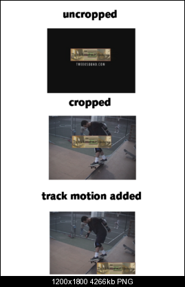

    sequence of work

    turn track motion on. move your cursor inside the internal rectangle, it should turn blue, hold down the left mouse button and drag the video to where you want it.
