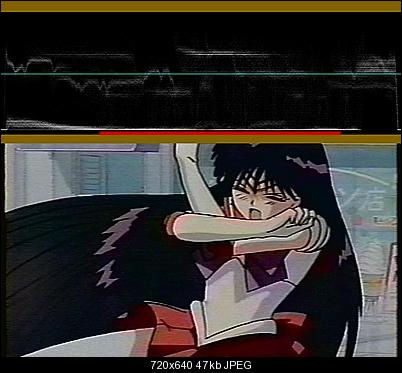

  1. From the waveform graph I posted earlier it looks like there was more dark detail in the area I marked in red here:
    That represents the characters black hair. That solid, sharp white line just above the red indicates that there were darker pixels but something along the capture path crushed them. You might be able to adjust the capture device's brightness and contrast settings to prevent that crushing. Or it might be happening earlier in the chain, maybe in the VCR's processing (disable all filtering in the VCR if you can). If it happened before the VHS recording there is nothing you can do about it.
    Regarding the meaning of contrast and brightness, different devices use those terms to mean different things. You'll just have to fiddle with them to see what you can get.
