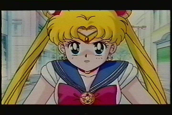

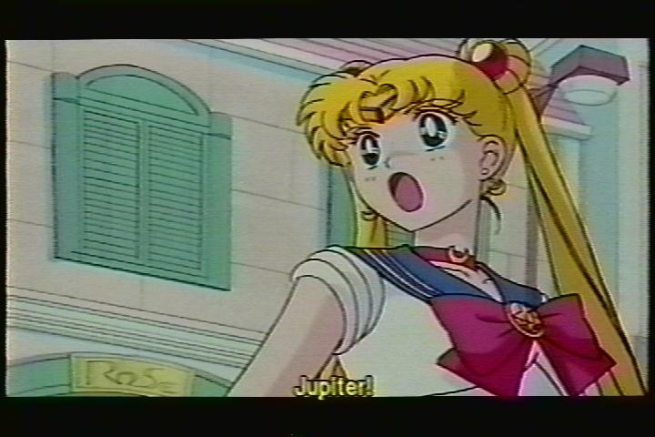

    This was my AVISynth script I used for my sample:
    setmtmode(2)
    AVISource("C:\Users\Public\Recorded TV\smrmovie -506ms.avi", audio=false).AssumeFPS(30000,1001)
    assumetff()
    converttoyv12(interlaced=true)
    animeivtc(mode=2)
    chromashift(l=-4,c=-4)
    crop(4, 4, -4, -4)
    Lanczosresize(640,480)
    fastdegrain()
    I didn't use a dehalo filter because they tend to make the subtitles look pretty bad I just checked my Proc Amp on my capture settings and they seem to be set at 2, which was the default. So I set it to 0, and then set the contrast from 32 down to 30 and captured a new clip, and these are the results after adding the exact same chain of filters. I've also attached untouched screencaps from the original capture files.
    My concern is this: would pairing two Panasonic devices together exacerbate the sharpening and contrast problems so much that my capture device's Proc Amp would be useless at fixing it? For example, would it turn Sailor Moon's skin the same shade of white as her costume? And then if that were to happen, and I used the Proc Amp to decrease the contrast, would that make her skin the same shade of gray as her costume? (maybe not in this particular scene but I do have some tapes where if I left the proc amp contrast at the default of 32, the captured video had her skin super white)

  20. Banned
    New York, US
    The coding gurus will have to look this one over. The one thing I noticed was...
    crop(4, 4, -4, -4)
    The lines in bold made my eyes smart a bit. Then I saw the that crop/resize was followed by denoising. rather than preceded by it. Having no idea what the unprocessed source looks like, I must withhold further comment on the processing. That's some rather messy chroma smear; It almost looks like tape played via composite. But maybe that's just the way the tape looks. It sure is rattling around inside the player, though (You'll be happier with a line tbc).
    Using a proc amp for anything more detailed than very basic levels and (perhaps) saturation correction can make life difficult because of the way VHS relentlessly changes color balance from minute to minute, and sometimes second by second. I guess it depends on the workflow.

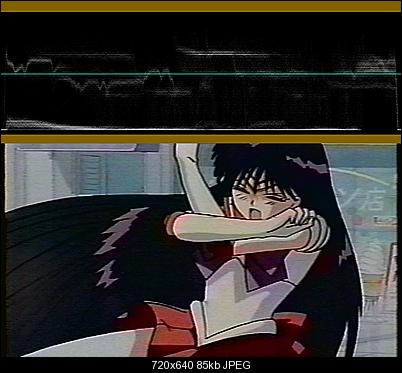

  23. Try adjusting your capture card's proc amp. You're getting crushed blacks somewhere around Y=24:
    You need to take care of that first. There's no way to fix it later.

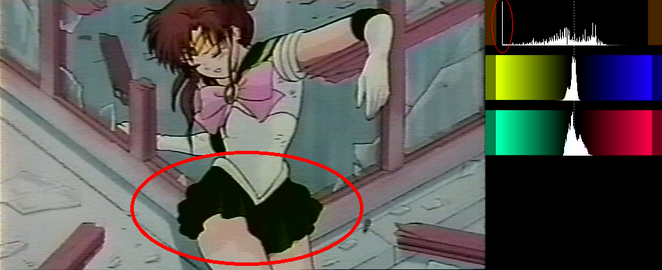

  29. Originally Posted by ChibiBoi View Post
    I've seen you post histograms in other threads while I was searching the forums, can you explain how to read them?
    The histogram I posted was with AviSynth's Histogram() filter. This is really a waveform graph, not a histogram:
    https://forum.videohelp.com/threads/340804-colorspace-conversation-elaboration?p=212156...=1#post2121568
    In short, it's a graph of the intensities of the image. The height of the line represents the intensity. The brightness of the graph indicates how many pixels had that intensity.
    When working with YUV you want to keep the waveform out of the yellow areas. You want blacks to be just above the lower yellow band (Y=16), and the brightest brights just below the upper yellow band (Y=235).
    AviSynth's Histogram() draws the graph at the right of the frame and works on columns instead of rows. To get a more traditional horiztonal waveform graph I turn the frame 90 degrees clockwise, call Histogram(), then turn the result 90 degrees counter-clockwise. Or you can use the VideoScope() filter. It draws a horizontal graph below the frame (actually it can draw at the bottom or the right of the frame and can show chroma graphs too) and can include tick marks within the graph. But it doesn't clearly demark the area below Y=16 or above Y=235.
  30. Member
    Jan 2006

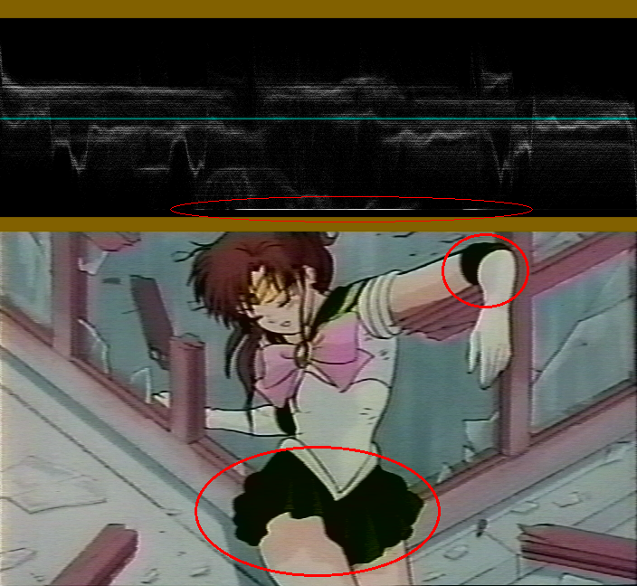

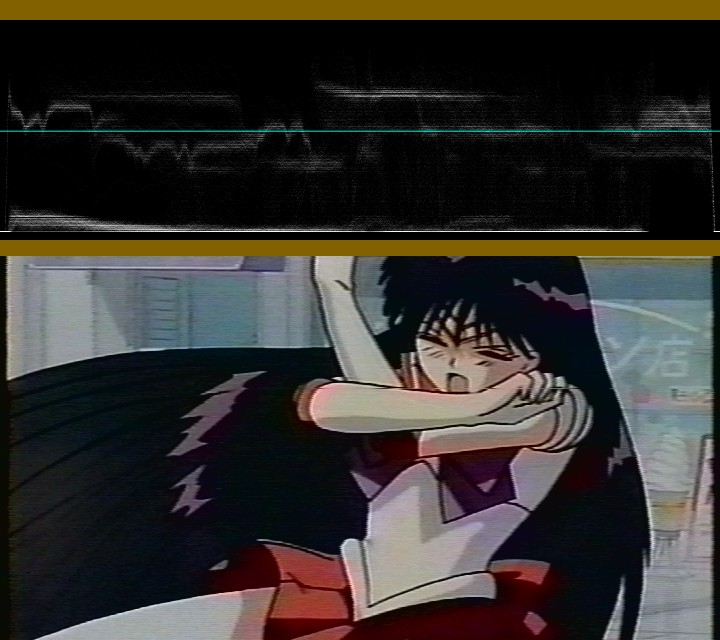

    Thanks jagabo, I understand how to read it now, but how can you use it to tell if there are crushed blacks? I'm assuming the indicator on the graph isn't the positioning near the yellow bands, since you said the darkest darks should be just above the yellow band. So is it because of the sheer intensity of the blacks at that position? And from what I described above, setting the capture ProcAmp to a lower contrast should solve the problem, correct? Though from what I saw by setting contrast 32->30, it seems to have dulled the color of the video as a whole
