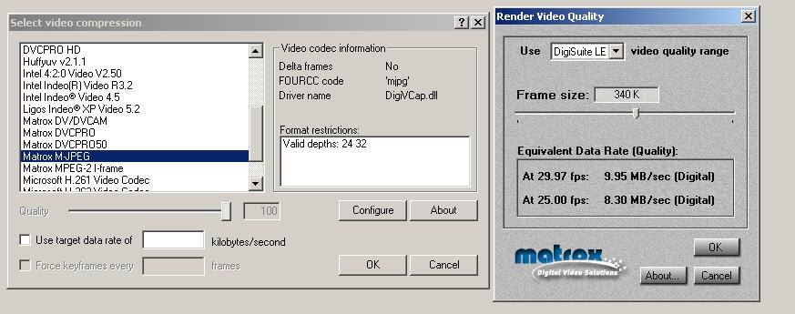

    The codec used for this .avi is a Matrox Digisuite LE codec (that I have put on the dropbox in the file "codec matrox.exe")
    Possibly I would to convert the HD file (C0100.MXF) without loss of definition and color depth.

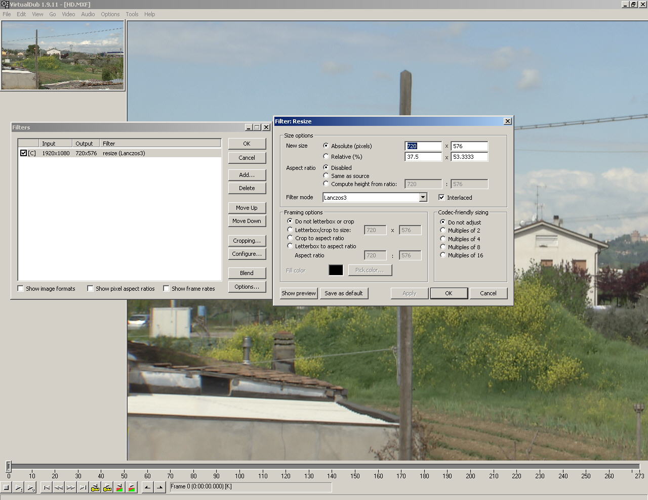

  4. I just tested this, loading one line Avisynth script: ffmpegsource2("C0100.MXF", atrack=1)
    into VirtualDub, choosing resize filter , 720x576, Lanczos3 resize and checked interlace box.
    File seems to be ok, it is regular SD that needs to be flaged 16:9 during encoding, just be careful it is Upper field first, your previous SD might be Bottom field first

    Hi _Al_
    I have installed virtualdub in c:\virtualdub
    and avisynth in c:\avisynth
    so I have to open the notepad and write:
    and I save this as c:\script.avs
    Then if I open virtualdub I have to do: "File-->open video file--> c:\script.avs" ?

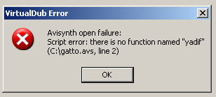

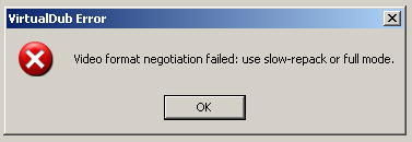

    because if I do this I receive the message: "Avisynth open failure: script error: there is no function named "ffmpegsource2"(c:\script.avs, line1)
    What I have to do? FFmpegsource is an external plugin for avisynth?
    Thank you
  6. yes, ffmpegsource is Avisynth's plugin, you need to download it from here http://code.google.com/p/ffmpegsource/downloads/detail?name=ffms-2.17.7z unzip and just copy/paste it all in Avisynth/plugin folder
    Even if you have windows 64bit, make sure you have 32 bit version of VirtualDub, 32 bit version of Avisynth . That link for ffmpegsource is 32bit also.

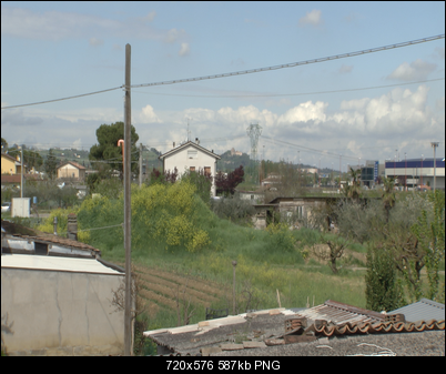

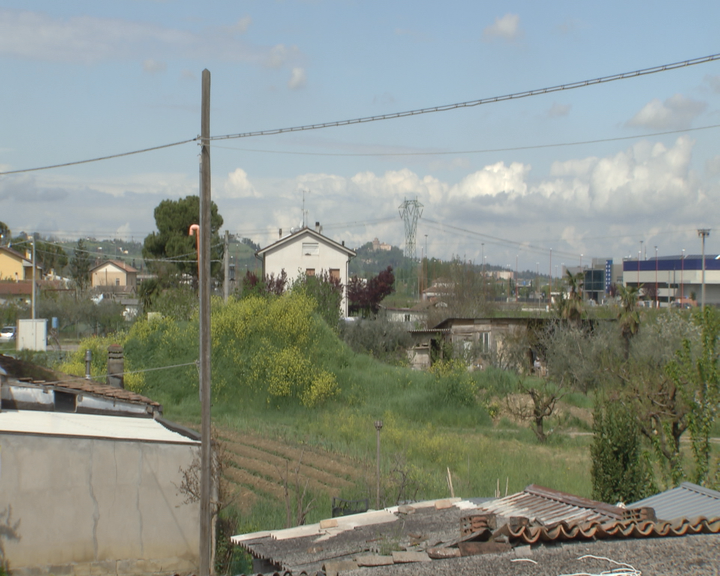

    now I can also open .mxf file in virtualdub with FFMPEG libreries, but the problem persist: I my dropbox have put 2 frame for understanding the problem
    and
    Frame OK show the encoding with Virtualdub by a file .mxf record with the Sony camera in SD mode (is a .mxf in IMX/D10encoding)
    Frame Wrong shown the Virtualdub-encoding of the same inquadrature of the camera but the camera recording the same picture in HD 1920x1080 mode. The result is the HD-->SD conversion is worse of the SD-->SD encoding: if you confrontinf the 2 images and switch by one to one it's clear the frameWrong.bmp has a loss of detail, gloss and depth of color.
    Though both are the final product of transcoding with Virtualdub.

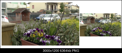

  8. aBigMeanie aedipuss's Avatar
    Oct 2005
    666th portal

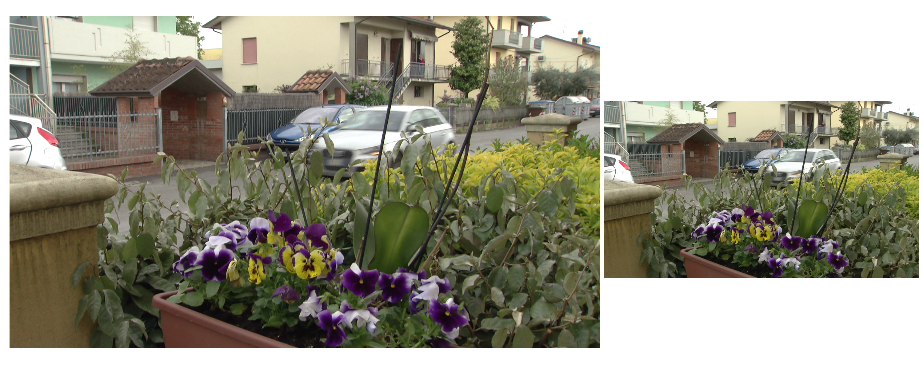

    maybe try using different tools. i took your mxf and ran it through mediacoder to make a huffyuv SD avi. look ok to me.
    your HD mxf on the left - SD huffyuv avi on the right
  9. yes, something else,
    about those colors I heard here on this forum that VirtualDub uses BT.601 even for HD source,
    about picture not that crisp, well, it is this interlace oddity that broadcasters seem to defend but we amateuers do not. They have some HW boxes that shape their videos as they need, not us. To resize HD interlace to SD interlace again is not easy. You can try QTGMC , do it all in avisynth, I just tried that, but I got error , it works in YV12, but that you do not want to change it to 4:2:0, maybe I cannot set it right or do not understand that:

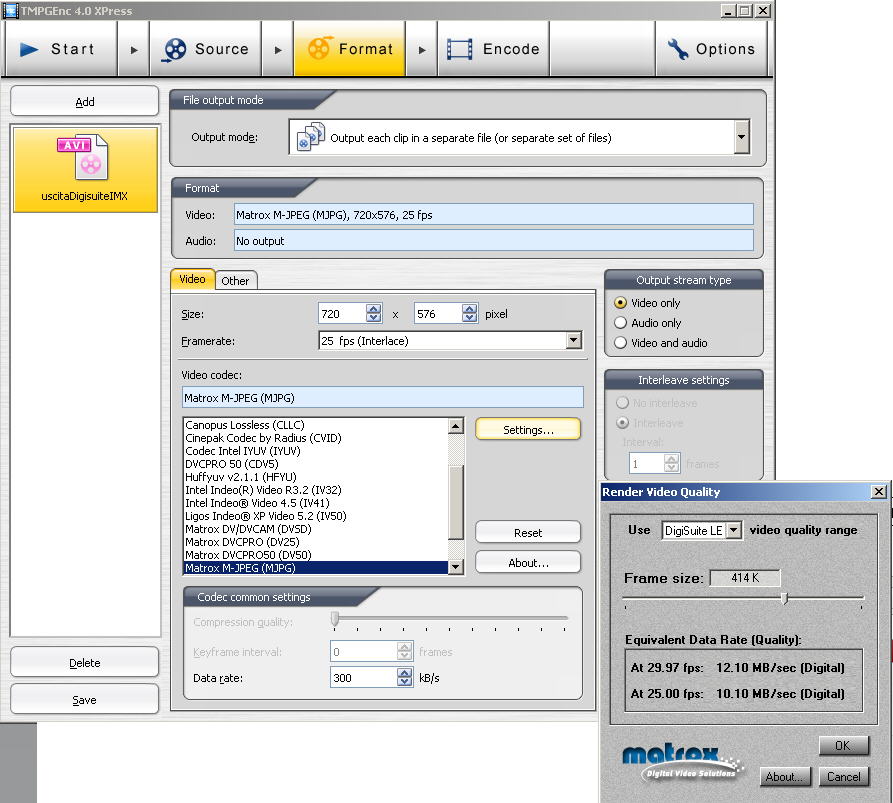

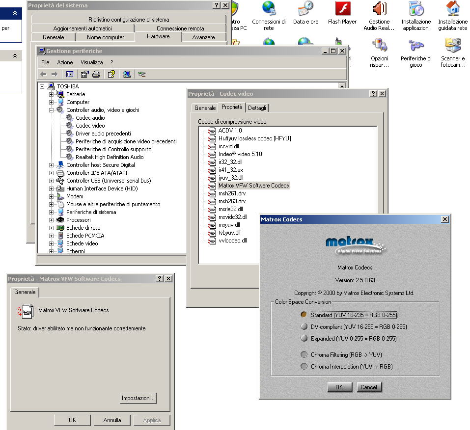

  11. ps: the matrox codec is configurable
    in panel control, system .. hardware, video codec, proprieties, matrox VFW codecs

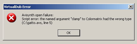

    You can use QTGMC in YUY2 mode if you swap the masktools for the 2.5 version (mt_masktools-25.dll)
    If you use ffms2 (vanilla version) it should output YUY2 ; but the ffms2 cplugin will output YV12 on xdcam-hd sources
    I would also use clamp=0 for colormatrix (it's actually clipping, not clamping in colormatrix)

    You can still use vdub to encode using matrox codecs, but it's important to input the avs script and use video=>fast recompress to prevent other color space conversions
    Also note, sometimes matrox codecs are not treated as YUV in other applications (sometimes they are treated as RGB in some NLE's - so that colorspace conversion can cause problems such as clipping) . I suspect it should be ok in a Matrox application , however . Because of this concern, it might be better to clamp the levels to 16-235 instead of keeping the full range if you use matrox codecs

    Thank you, but I'm constrained to Matrox Mjpg encoding. I don't know if HCGui/avisynth can export in Matrox Mjpeg .avi files

    It's actually pretty simple for this conversion. You basically copy & paste a script.
    Look at the instruction video for HD2SD (follow along step by step)
    http://bellunevideo.com/tutdetail.php?tutid=12
    You didn't answer the earlier questions I had, so I'm going to assume you want full frame , not pillarboxed, levels passed through
    1) Install avisynth and download the HD2SD package. Follow the instructions included with HD2SD for the prerequisite plugins (place plugins and avsi in avisynth plugin directory to autoload them)
    2) Download FFMS2 (vanilla version), place the .dll and .avsi in plugins folder
    3) Create a text file in notepad , changing the filepaths and names to match your files and folders. Save it. Rename the .txt extension to .avs e.g. (script.txt => script.avs)
    FFVideoSource("G:\PATH\HD.MXF")
    hd2sd(interlaced=true, OutputColorSpace="yuy2", inputPAR=1, outputPAR=1.4222, limitwhite=false)
    You can load script.avs into vdub directly, then use video=>fast recompress , video=>compression (select compression & settings), file=>save as avi
    The reason why the outputPAR is 1.4222 is you're using non ITU guidelines . The PAR is 64/45 for 16:9 PAL (so this would be full frame, not pillarboxed as in your other "outputOK.avi" example
    Note, by default, hd2sd will CLIP superbrights (by default limitwhite=true) . This means you lose data. Your other examples clamped the range. I didn't do anything else in the script, but you should be aware of this because you might want to make adjustments.
    SD.mxf (cropped to 720x576)
    HD.mxf => hd2sd

    Poisondeathray, with your help the situation seems much improved!
    Only 2 things:
    1) I get an error when I try to export with compressor "Matrox Mjpeg" (it can export in Uncompressed RGB/YCbCr) (I do use fast recompress, but if I set the full processing mode it's all ok)
    2) it seems necessary at least one filter e.g. Lanczos because the contour are raw and too jagged.
    Is possibile to add a line in the script of the a good filter (maybe even better of Lanczos3, if exist)?
    I heartily thank you

  21. Add ConvertToRGB() to the end of your script.
  22. Originally Posted by marcorocchini View Post
    It's because the codec you're using is probably expecting RGB , not YUV . I would use another codec .The problems with YUV=> RGB conversion are quality loss , superwhite clipping.
    The "fast recompress" mode is to prevent the colorspace conversion (you keep YUV 4:2:2 same as original)
    But if you insist converting to RGB, you probably want to fix superbright levels before converting to RGB (otherwise they clip)
    Then you would change OutputColorSpace=RGB in hd2sd , instead of YUY2
    If you use ConvertToRGB separately, you should use interlaced=true
    ConvertToRGB(interlaced=true)
    I don't understand what you're asking ? Can you clarify ?
    Lanczos is for resizing, and it's sharp (it will enhanced edges)
  23. Oh, I forgot, many MJPEG codecs use video range RGB. So you probably want to use ConvertToRGB(matrix="PC.601").

  27. Download yadif.dll
    http://avisynth.org.ru/yadif/yadif.html
    but it's a CPlugin , so you have to load it with LoadCPlugin
    LoadCPlugin("PATH\yadif.dll")
    FFVideoSource("video.MXF")
    Yadif(1,1)
    LanczosResize(720,576)
    Colormatrix(mode="rec.709->rec.601", clamp=0)
    AssumeBFF().SeparateFields().SelectEvery(4, 0, 3).Weave()
  28. LoadCPlugin("c:\avisynth\plugins\yadif.dll")
    FFVideoSource("v:\mxf\hdmovimento.mxf")
    Yadif(1,1)
  29. You probably different colormatrix plugin version, try clamp=false
    I'm using 2.5
    http://web.missouri.edu/~kes25c/ColorMatrixv25.zip
