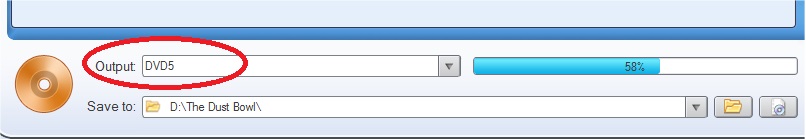

    DVD Fab does shrink and I find it a good program.
    Select DVD5 from the output dropdown list

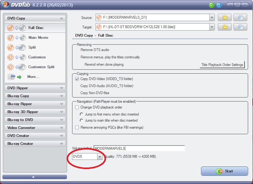

    All versions of DVD Fab will shrink a DVD to fit on a DVD5, you are obviously doing something wrong.
    From the main screen, select the DVD Copy option.
    With a DVD in the tray, Select Full disc, and you will see a drop down box at the bottom that has 2 choices, DVD5 and DVD9 as circled in the image below.
    When the trial version has expired, the part of the program that still operates (DVD Fab HD Decrypter) may not be able to decrypt the latest protections but will still work perfectly well for older DVDs.

    You are right about my not finding 9.2.2.4 version now that I think about it, and the initial version I found I thought was latest version was actually 9.0.2.4 not 9.2.2.4. That 9.0.2.4 version did not have the "Quality" drop down where DVD5 can be selected, and I saw no selectable menu tab to choose DVD5 or to shrink the ripped output. However, I now I find 9.0.2.4 was a beta version according to http://forum.dvdfab.com/showthread.php?p=133356 which may be why no DVD5 selectable option was found since that's a beta version. Thanks for the helpful info.
