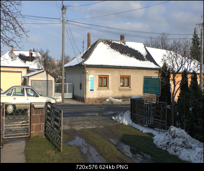

    This video I attached was recorded with a Panasonic X900 Camcorder in Full HD. When it is downconverted to PAL DVD resolution, the electric cables in the video become zig-zag. What causes it? Is it possible to have straight, even lines without zig-zags when converting to DVD, or this is something you cannot avoid? I attached a screenshot about this problem in the DVD video, too.

    Because it's interlaced. Interlaced PAL DVD is 50 fields per second (50i or 25i, both are the same thing, just different naming conventions), Not 50 frames per second . You can think of each field like half a frame, contains only 1/2 the spatial information. When you pause it like that you 're looking at a field resized to full size frame, so you will see aliasing artifacts or "jaggies". When viewed in motion, those "jaggies" can buzz or flicker, also known as "bob flicker"
    Only way to avoid these artifacts is to keep progressive (full frames), but 50p is not supported by DVD . Only 25p. So you will lose the motion smoothness

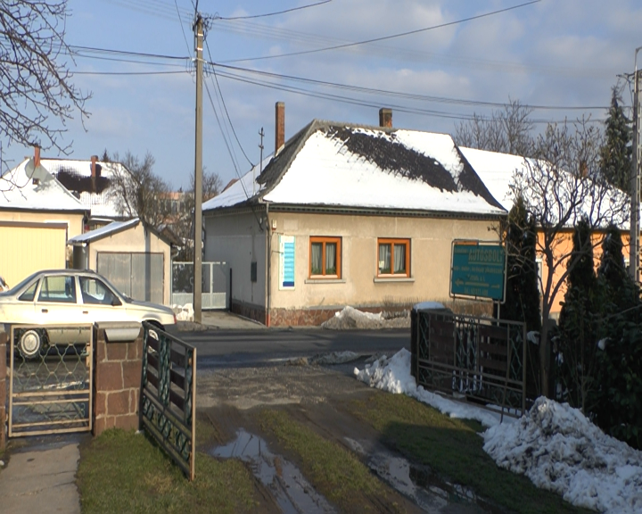

    "good" software bob deinterlacing (convert 50 fields to 50 frames) methods fill in those jaggies by interpolation and looking at fields before/after. They look almost perfectly smooth. Most HDTV's use simple bob deinterlace (simple resizing) , and the quality is poor compared to complex software methods like QTGMC in avisynth . Some more expensive HDTV's have motion adaptive deinterlacing algorithms, but even the best ones are worse than QTGMC . Essentially what I'm saying is when you have interlaced DVD, you're at the mercy of the HDTV's quality of deinterlacing. Some are pretty good, some are very bad.
    You can see the difference good deinterlacing quality makes; most flat screen TV's will use a simple bob only, because the other algorithms require more CPU and processing power, not suitable for realtime playback , or it would cost too much to the price of a TV to add such a feature
