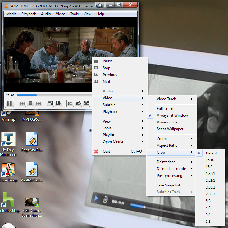

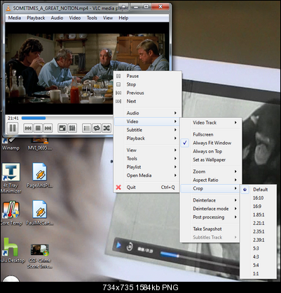

  6. Member olyteddy's Avatar
    Dec 2005
    Do you use VLC to watch them? You can set Aspect Ratio and Crop to fix that.
