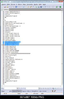

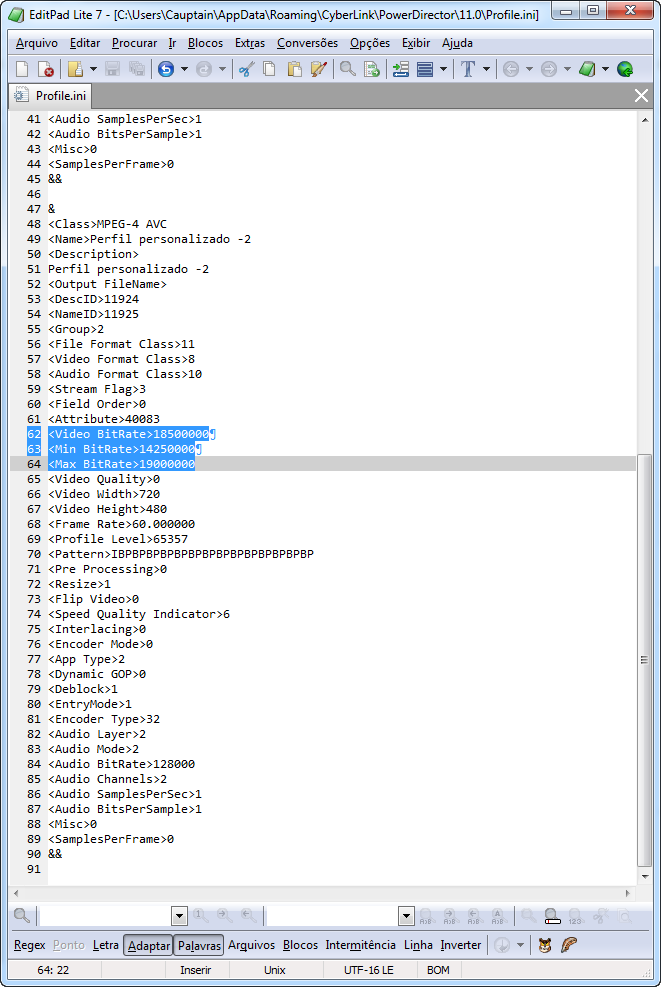

    This way to "trick" this is create a new profile, search this on APPDATA folder and change realtime and save your file.
    On windows Vista/7/8
    "C:\Users\your user here\AppData\Roaming\CyberLink\PowerDirector\10.0\profile.ini"
    Edit these parameters as you like:
