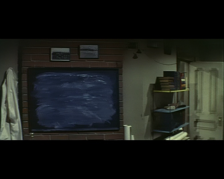

Decimating this kind of damaging spot means to sacrifice the picture quality?
RemoveSpot() really cause visible detail loss.
I already mentioned this. RemoveSpots() is quite damaging . The MC (= motion compensated) variants are less damaging more selective . E.g. RemoveDirtMC(30, false)
https://forum.videohelp.com/threads/355282-How-to-improve-this-color?p=2234841&viewfull=1#post2234841
Compare the screenshots , you can see entire textures , bricks, are missing. This is typical for RemoveSpots()
ALL automatic dirt/spot/dust removal filters are damaging, and prone to remove small details. You can adjust the strength to remove more or less , at the risk of either missing spots or removing details. The "best" way is to use multiple strengths (e.g. a weak filtered, strong filtered) with multiple layers and a compositor - but it takes some manual input but it's basically a perfect repair, and a lot faster than photoshop
Original
Name:	383 original.png
RemoveSpots()
Name:	383 removespots.png
RemoveDirtMC(30,false)
Name:	383 rdmc(30).png
