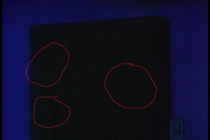

    Hi folks. First let me state that I do not know of any denoising script better than MDegrain (3 to be specific). Results are gorgeous except for one small thing: frame blending in dark scene changes. As you'll notice in the slammed door (frame 147) in my POST Filter sample. If you look closely, you'll notice some details from the following frame. this is not going to fly with what I'm doing, so I thought of one solution:
    I know that lowering thSAD1 and thSAD2 does it, but of course, this leads to poor denoising results. My solution at this time is using trim() by ONLY lowering the SAD in the affected frames (such as frame 147) and then returning the original script for the rest of the scene, until I run into a similiar scene. But I don't know. Somehow I feel that there's a much "cleaner" way to do this. In any event, attached are 3 files: The prefiltered, the post-filtered, and an image of the actual damaged frame caused by the filtering.
    Let me know if you have any suggestions, please.

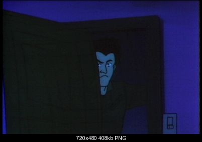

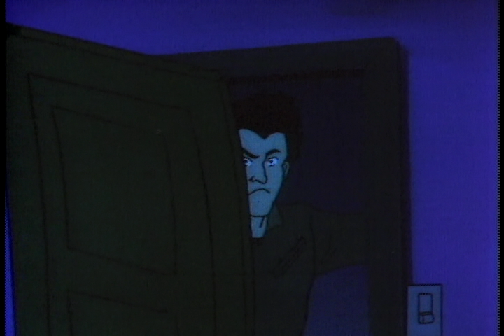

    Some comparisons :
    smdegrain (smdegrain default setting is almost the same thing as mdegrain3)
Name:	154 smdegrain.png
    darkline multiplied mask overlay as prefiltered clip into smdegrain(reduced settings)
Name:	154 darkline_multiply.png
