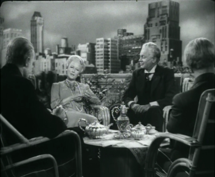

    Just as the picture shows, the upper left corner is damaged badly. Other screen in this movie is OK, just this few seconds.
  2. I don't think that's damage but rather the corner of the film. If it's just a few seconds why bother "fixing" it? About the only thing I could recommend is overlaying the a shifted (up and left) version of the picture with an alpha mask.
  3. Member hech54's Avatar
    Jul 2001
    Yank in Europe
    Is this a joke?
  4. I just thought that, since even logo on pictures can be covered (or to say "fixed") manually, why can't this kind of damaging edge?

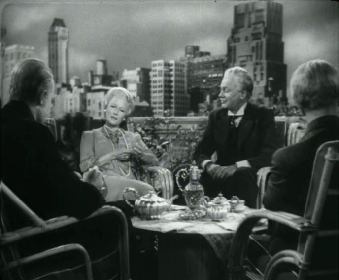

  5. quick shift/mask/overlay:
    Not great but a little better.
  6. I was afraid that the restoration to this few frame would have bad effect on other frames... Still lost in thoughts.
  7. Originally Posted by xuguang_he View Post
    Trim()
  8. I was afraid that the restoration to this few frame would have bad effect on other frames...
    isn't that what ApplyRange(..) or trim(..) is ment for?
    Cu Selur
    Ps.: jagabo was faster
  9. But I forget to mention ApplyRange(). I was just about to add it when I saw your reply.
  10. You can also use ReplaceFramesSimple().
  11. Thank your for your replying I'll get a try now.
  12. Is it a static background frame ? or does background move, or camera move ?
    Since it's only a few seconds, you can probably inpaint / clone brush or healing brush / it with photoshop / gimp / image editor of your choice
    And if the defect doesn't move (always top left) you can batch process so it's automatically repaired so you don't have to manually do each frame
    There are some inpainting / logo removal filters you can try in avisynth, but it won't get you as good results as something like photoshop
