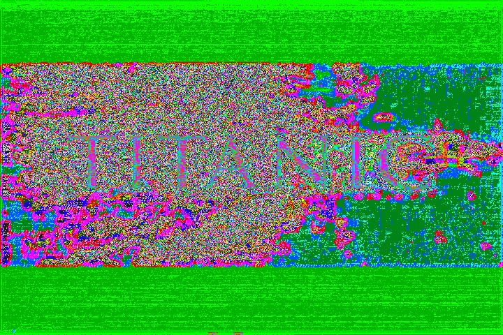

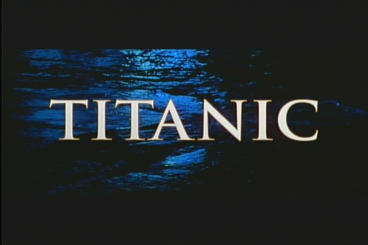

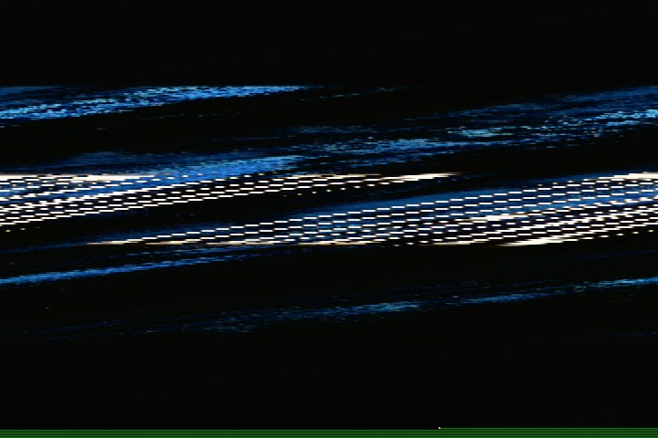

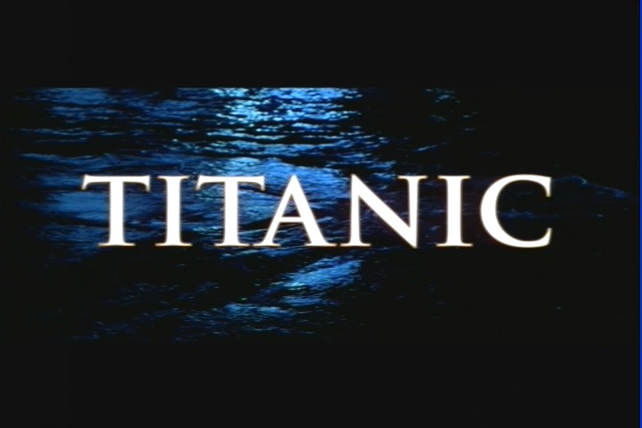

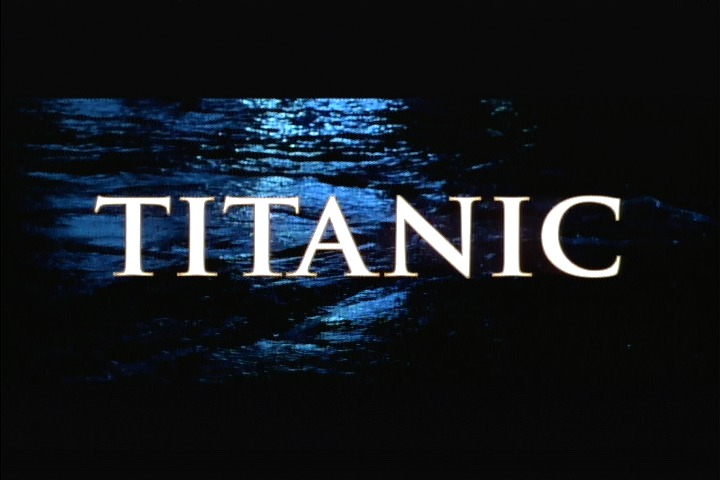

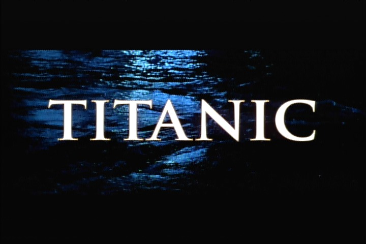

    Finally got a good DVD trigger for Macrovision. Here is the original single-disc Titanic DVD release captured with the devices I have here.
    ATI 600 USB
    ATI 750 USB
    Mygica EzGrabber2
    Diamond VC500
    Easycap STK1160
    AV Grabber USB 28285
    [Attachment 17834 - Click to enlarge]
    [Attachment 17830 - Click to enlarge]
    [Attachment 17831 - Click to enlarge]
    [Attachment 17832 - Click to enlarge]
    [Attachment 17833 - Click to enlarge]
    [Attachment 17835 - Click to enlarge]
    Going to try out playing around with the drivers for the Conexant Polaris devices.
