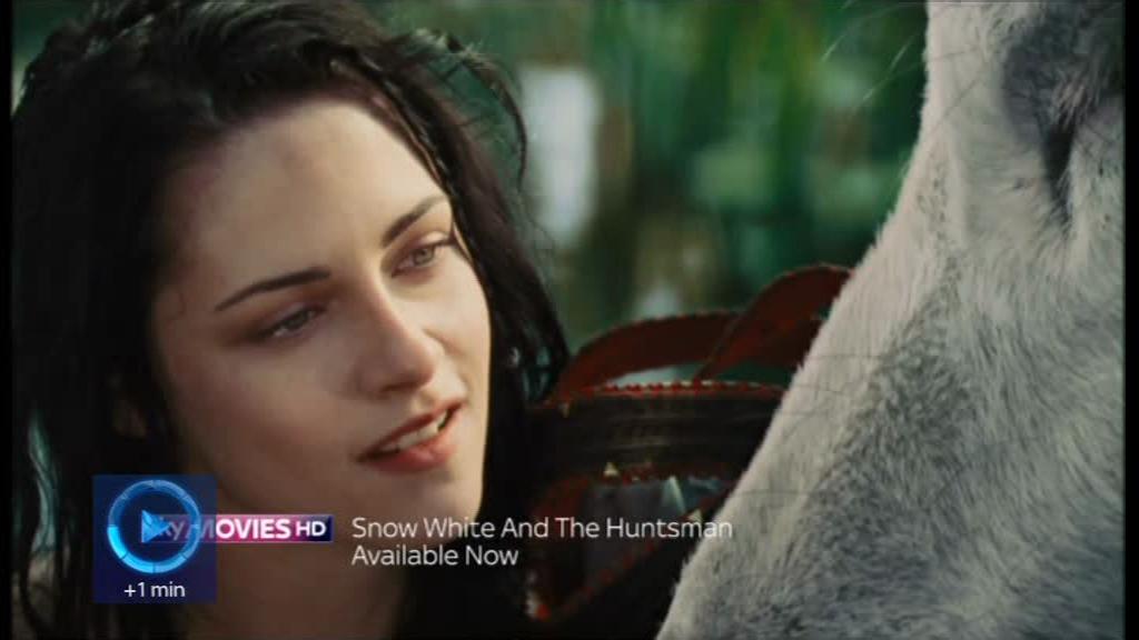

    I have recorded some stuff from cable TV using the scart output and have a slight problem..
    I'm fairly sure I have it all configured correctly with regard to aspect ratios, and when I put the recorded DVD into DVD players the results are very good.
    However, when I view the disc on the PC, there is a black line to the left of the screen, leaving it looking a little unbalanced. I'd expect there to be one on each side if it was an aspect ratio thing but it's only on the left.
    Is this something to do with overscanning? I've messed with VLC settings to see if I can change it but it remains the same. Any help would be appreciated!

    Thanks for the reply. Though it's not a border - just on the left:
    Screenshot

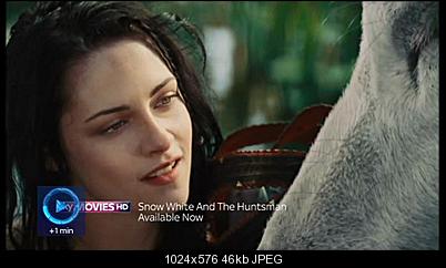

  6. I doubt your DVD recorder has any settings you can change to better center the picture. Analog PAL signals have an active picture of about 702x576. The DVD recorder records at 720x576, capturing a little extra to the left and right. A different recorder, or a different source, may better center the image -- but then you'll have black borders (half as wide) at the left and right.
    [Attachment 17363 - Click to enlarge]
    That's the strange thing, there's no extra captured to the right, it's just the left. I have the cable outputting to the DVD recorder using RGB for the best quality. I wonder if there's something there I should change.
  8. Originally Posted by Schreck View Post
    There's nothing strange about that at all. It's very common.
    Doubtful.
    Cable companies, recorder manufacturers, etc. don't care about centering problems. They "know" that TVs overscan and you can't see the edges of the picture. That's why digital recordings capture more than the active picture content. So they don't have to worry about perfect centering.
