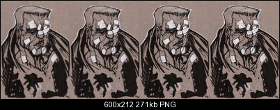

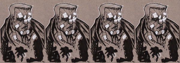

  25. Which resizing should i use for photos? Is it ok if i use spline resizer for this? I resized the photo with irfanview but it looks very bad.
  26. Use whichever resizer looks best for the particular photo. If your source is already sharp a sharp resizer will create oversharpening halos. And are you upscaling or downscaling? And by how much?
  27. I'm downscaling from 825x1163 to 150x211. I want to use it as avatar.
  28. Resized to 150x212. Bilinear, Bicubic, Spline16, Lanczos:
