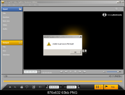

  17. I got this error when i tried to open a 10-bit mkv file in Solveig video splitter. What should i do to fix this?
  18. Use 8 bit encoding?
  19. Which software should i use for trimming 10bit videos?
  20. No idea. Why don't you trim before you encode?
  21. MKV Cutter might work, if you replace the x264 binary which comes with it with a 10bit variant.
    (+ I agree with jagabo, cutting before reencoding is normally the preferred way to go and not the other way around.)
  22. By the say, I don't know for certain that Solveig doesn't support 10 bit h.264, I was just speculating about that. But in general, many tools don't work with 10 bit h.264 and very little outside of a full blown computer can play it. That's a big tradeoff to get slightly better visual quality.
