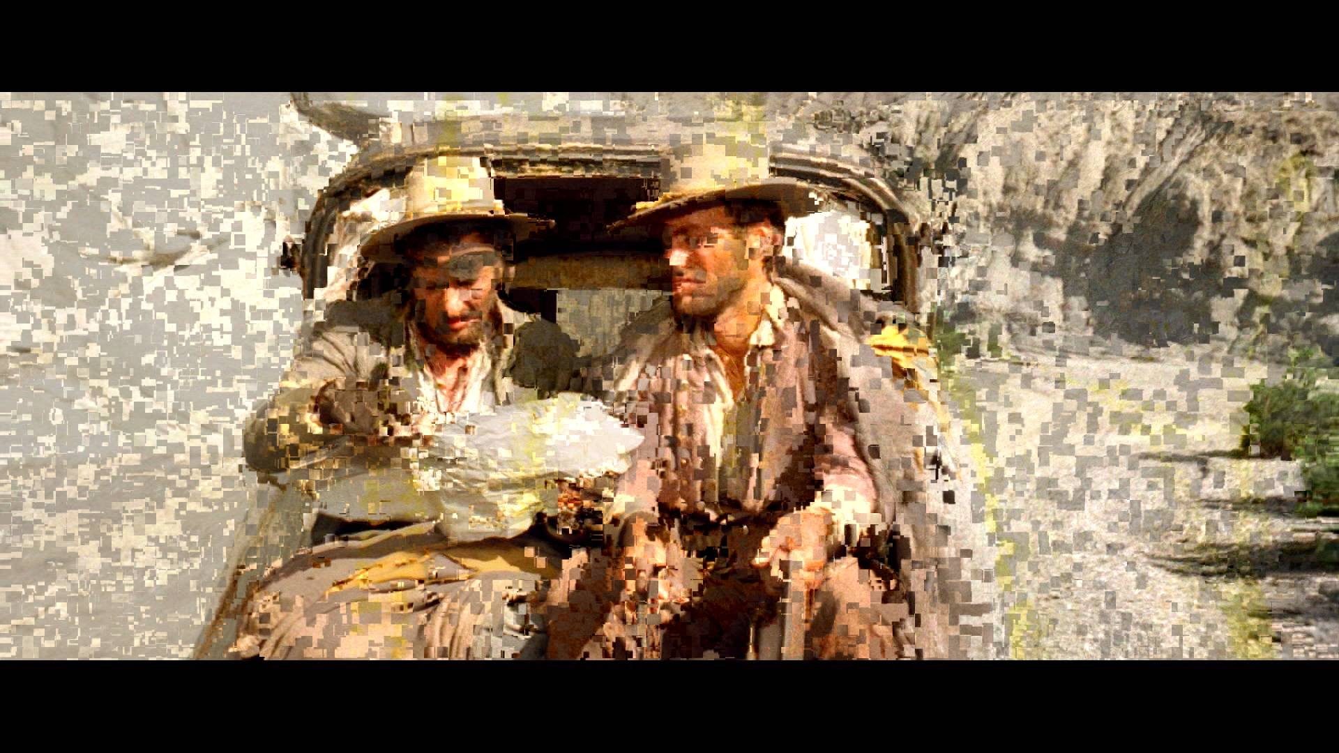

  3. Looks like mostly blue channel affected. How many frames are affected, and what is the distribution / pattern ? If it's just this one scene , can you upload the clip ?
    This looks like it will be tough to do a good job without manual work & masks, but there might some tricks you can use depending on the pattern
  4. For a few frames here and there you can try replacing them with motion interpolated from the frames before and after.
    https://forum.videohelp.com/threads/352741-Frame-interpolation?p=2226119&viewfull=1#post2226119
    For example, InsertFramesMC(100,2) will replace frames 100 and 101 with motion interpolated from frames 99 and 102.

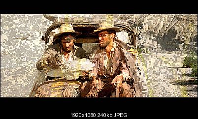

  5. I can't get that clip (even after remuxing) to play (or otherwise decompress) properly in any player or editor:
  6. seems like the file is missing some headers otherwise at least mediainfo should show resolution&co,..
    -> without a proper source, nothing to do

  8. doh used 'save as' instead of following the link (ffplay works fine)
  9. works ok here
    mkvtoolnix , ffvideosource()
  10. I used DGIndexNV to trim the source.
  11. raw +
    avisynth + DGSource works fine
    avisynth + FFVideoSource shows only a single frame
    avisynth + LWLibavVideoSource -> crash
    remuxed to mkv
    + mplayer: broken
    + DirectShow based player with Hardware decoder: everything is fine
    seems like libav has some problems with the stream depending on the used version
  12. Since only the blue channel is affected, ideally you want to limit repairs to blue channel.
    1) One approach: The distribution of the artifacts means some of the yellow spots are amenable to heavy dirt removal plugins by applying to blue channel (basically cleaning the blue channel). You need to ConvertToRGB (709) in order to showblue(), ConvertToYV12(709) to use the dirt removal plugins, convert back to RGB, then mergeRGB (r,g, fixed blue) . The problems with this: a) not perfect; will miss some areas - depends on what filter stack / combo used b) false positives will make blue spots
    2) Another method : you can attempt reconstruct the blue channel by manipulating R,G , but the colors will be "off". You would need to do big time color corrections and rotoscope some ares back in (some areas are supposed to be "yellow", like the yellow cape, yellow sergeant stripes etc... those will be faded unless you mask/layer them back in) . Something like colourlike() may help if you're not good with color correcting
  13. A simple MergeChroma(McTemporalDenoise(settings="very high")) will pretty much eliminate the yellow spots. It's very slow though.
    <edit>
    Toward the end there is just too much of the yellow discoloration for MCTD.
    </edit>

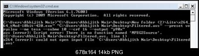

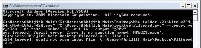

  23. Did you load the DGDecode.dll? Did you make a D2V project file? What's the complete script you're using?

  25. Is DGDecode.dll in AviSynth's plugins folder? It should autoload if it is. Otherwise you need to explicitly import it into your script:
    LoadPlugin("C:\Path\To\DGDecode.dll")
    Mpeg2Source(...)
    etc.
  26. I have the DGDecoide.dll in the avisynth+ plugins folder. The error appears only with the 64bit build and not the 32 bit build.
  27. 32 bit editors/encoders/players require 32 bit AviSynth and 32 bit filters. 64 bit editors/encoders/players require 32 bit AviSynth and 64 bit filters. You can't mix and match 32 bit and 64 bit components.
