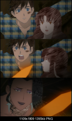

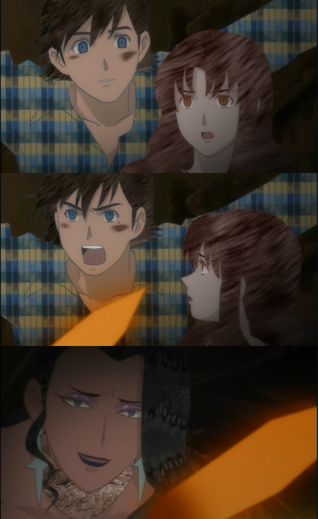

  15. 1) There is an avs import plugin but it is not reliable for CS5/6 because you need avisynth 64bit (which isn't reliable, very buggy) . You don't have to use megui, you can use the same script with vdub (video=>fast recompress to preven colorspace conversion) , or any other GUI front end that accepts avs scripts, and use a lossless intermediate e.g. ut video codec , for import into premiere. But why are you importing into premiere ???
    2) AA should improve that but will always damage fine details to some extent . There are literally dozens you can choose from . AA should be applied before your upscale if you choose to use it - you have to play with them and the settings to determine which one works better for this source without damaging too much.
    Instead I would try to determine what's causing it - e.g. is it really in the source, or maybe a bad IVTC (could you have used better settings ? maybe adjust the combing threshold ?) . Upscaling can cause jaggies too. A simple spline resize will cause jaggies but EDI based resizing (e.g nnedi3_rpow2) will not at the expense of fine details. Or maybe another option is selective filtering if it only affects certain sections - this way you don't damage the entire thing unnecessarily
    Was this sequence uploaded in one of the samples ?

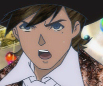

    Maybe not pure black, but I'm referring to "rainbows" that probably shouldn't be there
    Just zoom in (e.g upscale) without any other filters
    eg. this was from one of samples, just resized with spline36resize(1280,720), and cropped
    Look at the "black" lines around the nose, chin, etc... have multicolors . At least I dont' think they should be there. Who knows, maybe he's a "colorful guy" :P
  22. Member
    Feb 2009
    Germany
    Phew...no sry, barely a little cyan and maybe red next to it...I get the point.
    But is the source then?
    How is that called?
    What can one do about it?
  23. Originally Posted by Weef View Post
    How is that called?
    This is in the source. I would call this rainbows or chroma noise.
    If you didn't like it you would apply a derainbow filter or chroma noise filter
    e.g
    fft3filter(plane=3, sigma=3, bt=2)
    Of course, you can adjust the strength to remove more or reduce it to remove less . I only reduced it a little here, but you can increase sigma to increase the effect. If you raise it too much, the blue hue will disappear from the lines, and they will become more "black". Maybe you want that, maybe you dont....
    You can add other filters, etc.... whatever you want
    Generally when you upscale anime, you add some mild denoising, upscale, then some mild sharpening
