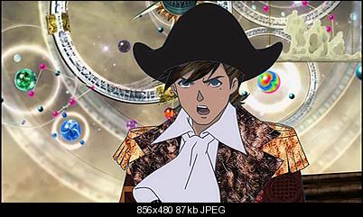

  16. Is this something like what you're looking for?

    No...no, the clothes pattern has already lost the strong contrast it still has with 752x480, I could probably even go up to 784x480.
    If the outlines were a little stronger in their appearance I would probably say: "I would like to know how u did it?". ^^
    http://www.file-upload.net/download-7485205/cobras.zip.html
    I think he is the one with the costume where differences in contrast and precision stand out the most
    at least these are shapes that are familliar...in some way

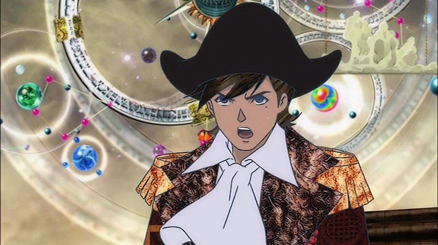

    The coat collar pattern is changed because I'm guessing he used EDI based resizing . It connects lines, and works as antialiaser, at the risk of reducing small details . You can choose something else if you want, there are many options
    You can thicken dark lines with awarpsharp2(depth= negative number) , or darken lines using various line darkeners (e.g. toon, fastlinedarkenmod etc...) . It depends on the "look" you are going for.
    You can use edge enhancement to enhance the aliasing present in the source (it's really false detail, but if you like that "look" - it's really up to you - It's very subjective
    e.g

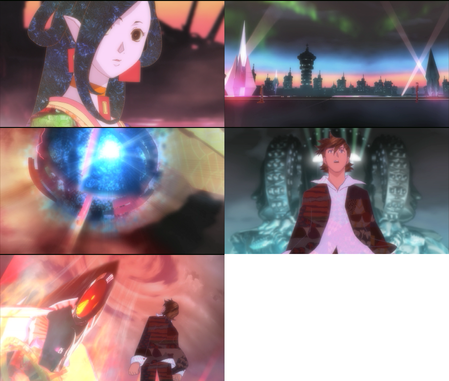

    I tired to upload antoher sample....which might have had characteristics we didn't have in the other scenes - didn't work.
    So I simply say, I like poison's way better.
    It feels slightly less exposed.
  26. Jagabo did that on purpose as an illustration of oversharpening . You can see "halos" or outlines on the line edges

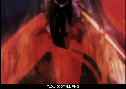

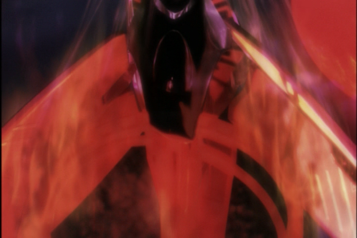

  27. Originally Posted by Weef View Post
    Why was this uploaded ? What are we supposed to be looking at ?
    A quick look shows some sequences are oversaturated , obscuring details . Looks like somebody made a mistake when producing this dvd
    original
    tweak(sat=0.6, coring=false, dither=true)
    (I'm not saying you should use those values, just for demonstration purposes that they made this scene too saturated)

    That could very well be.
    Till now I only noticed some gradients in the US version, that's why I got myself another version in... 2009?.
    Still not sure....the differences are minimal.
    Here the same in the US version.
    Snapshot out of Mpg2Cut
