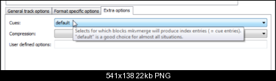

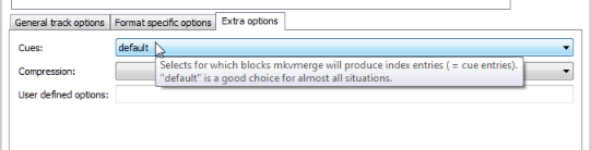

  1. In mkvmerge, under extra options, there's this option called cue.
    The tool tip says:
    Does it mean that, it creates indexes throughout the timeline, so that the video lands smoothly whenever we jump over the timeline? Like when playing in vlc and using shift+arrow keys.
    Because, i have an mkv(encoded in Handbrake ) which goes crazy whenever i jump through the timeline. This file is more or less okay when shifting backwards. The video goes 4 or 5 seconds behind as it should. But when shifting forward, it seems like its moving, but plays back from the frame where i was when shifting forward.
    Thought that i could use this cue feature to fix it, but it didn't help, rather made worse.

    The term "cues" in the Matroska terminology means the same as the term "index" in the AVI terminology. For video streams, the default setting means "create a list containing only the keyframes". And yes, the goal is make seeking easier.
    NOTICE: if you have an MKV file created with the option "generate cues for ALL frames", and try to fix it with mkvmerge, the trick will not work (according to the documentation, at least) --- you would have to first demux the input file to *elementary streams*, so that mkvmerge can generate a proper index this time.
