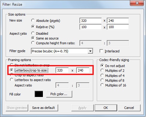

    Is your source larger than 720x576? Then you have to use the top part to resize first. And why are you using 720x576? Are you making a DVD? Did you adjust for the pixel aspect ratio of 16;9 DVD?
