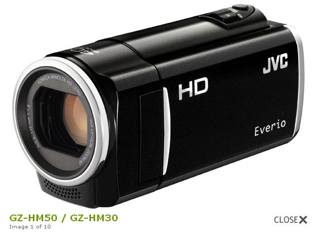

    so paying it forward. if you have a JVC Everio GZ-HM30 720p camcorder (see picture)
    that records 720p MTS files you can use avidemux to losslessly edit those files
