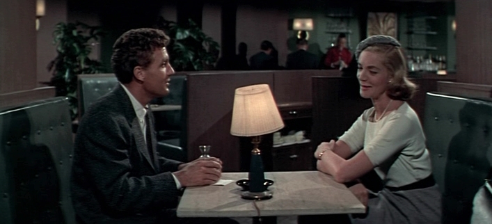

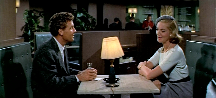

  1. Originally Posted by xuguang_he View Post
    " SmoothTweak(brightness=7, contrast=1.3, saturation=1.5, hue1=5, hue2=0) "
    You need to use gamma rather than contrast. You've blown out the brights and your black level is too high. Something like ColorYUV(gamma_y=100, gain_y=40, off_y=-13) will approximate Sanlyn's levels adjustments. Then follow up with your color adjustments.
    But I believe that is not what you want to do with the shot. You're turning a dark romantic dinner shot into lunch at a diner. Though, I don't know the movie. Maybe it is lunch at a diner.

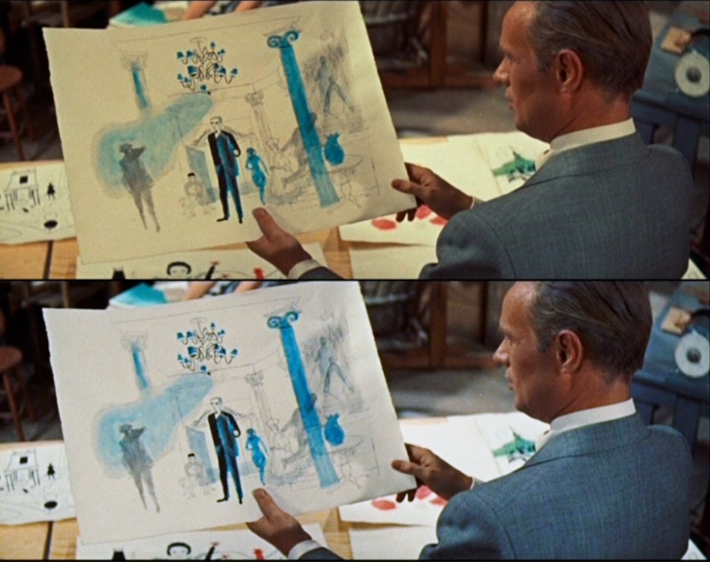

    Abd my scene with Richard Widmark holding the drawing as a new problem: it's too blue. Oh, well.....
    True. Those work much better than "contrast" in many ways.
    The whole movie is rather bright, as was the style in those days. But bright contrast in my shot is rather high (the lamp has a hot spot). A curve filter would taper off above RGB 200 or so to fix that, or something like "SmoothLevels(0, 0.95, 255, 12, 230) to taper the high end. Looking at something a day or two later changes many things. The scene is still too orange. Both people seem sunburned.

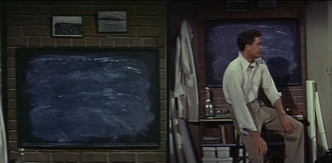

    BTW, I wouldn't recommend RemoveSpots() here. OK for static scenes, but here's what happened to a camera pan in the "Gift" sample #1, using nothing but Remove Spots, no other cleanup. Here are portions of two frames from the clip. On the left, note the big white dot on the blackboard. On the right, The white dot is just behind RobertStack's head. That white dot is supposed to be there:
    The attached m2v shows the effect RemoveSpots() can have sometimes -- on the white dot and several other elements. Moral: some things are better left as-is.
  6. LOL. That's not a chalkboard. It's an HDTV and the dot should be blinking!

  8. That's why it's advisable to use something more selective, like the MC variants of dirt/dust/spot removal plugins.
    RemoveSpots() is way too damaging . Look at the brick wall , entire bricks and textures are missing! Books have their printing removed etc...

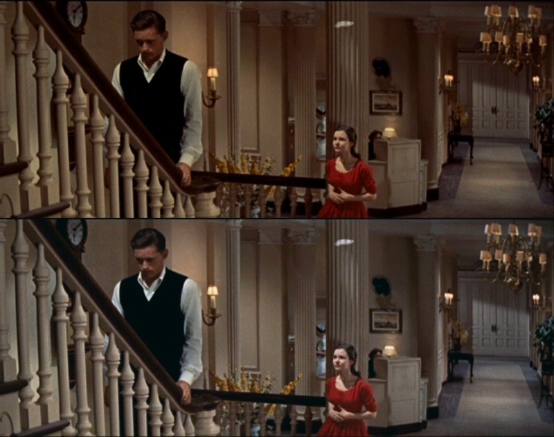

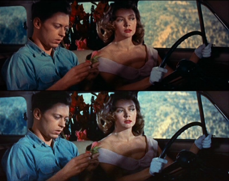

  23. By adding levels="TV->PC" to ColorYUV you've crushed blacks and brights.
  24. Adding this levels="TV->PC" made my picture more closer to sanlyn's screenshot, otherwise, I get no idea.
  25. Member budwzr's Avatar
    Apr 2007
    City Of Angels
    Which one is "fixed", the top or bottom?
    Start by determining the white point and black point. It helps to keep luma and colors within 16-240 spec. I made some quick notes of problems to look for:
    Image 1: Too green. Blacks, grays, whites off-color. Undersaturated. Low gamma. Darks crushed.
    Image 2: Too green. Blacks, grays, whites off-color. Undersaturated. Low gamma.
    Image 3: Too green. Blacks, grays, whites off-color. Low Gamma. Darks crushed.
    Image 4: Too yellow. Blacks, grays, whites off-color. Low Gamma. Undersaturated
    Image 5: Too yellow. Undersaturated. Low gamma, brights suppressed.
    Image 6: Blue suppressed. Undersaturated. Low gamma.
    Image 7: Too green. Low gamma and contrast. Uneven color: darks and brights have different color balance.
    Image 8: Too green. Low gamma and contrast. Poor midtone/bright balance.
    Image 9: Too red. Oversauratd, darks crushed and corrupt, brights pushed and clipped. midtones suppressed. Grainy shadows.
    Image10: Oversaturated. Too red. Darks crushed, low gamma.
    Image 11: Too yellow. Low gamma, brights clipped.
    Image 12: Low gamma, darks crushed. Midtones too red, brights yellow, blacks red.
    Image 13: Oversaturated, highlights pushed. bright reds pushed, midtonees green.
    Image 14: Oversturated. Too dark, reds pushed, brights green. Grainy shadows.
    Image 15: Color completely corrupt, oversaturated, reds pushed, blacks blue and crushed, highlights clipped.
    5 sample corrections with gradation curves, Color Mill, Levels. Primary white-black points determined with After Effects.
    [Attachment 17291 - Click to enlarge]
    [Attachment 17292 - Click to enlarge]
    [Attachment 17293 - Click to enlarge]
    [Attachment 17294 - Click to enlarge]
    [Attachment 17297 - Click to enlarge]
    I made only one quick pass at these. A few gave me a lot of trouble. I tend to look for convincing color and levels. Sometimes it's just a matter of taste, but over saturation is usually a turnoff. To each his own.
    Someone posted earlier that this DVD looks like something mastered from tape. It sure does.

  27. Banned
    New York, US
    The notes refer mostly to the jpg images -- which we see, from your posted sample clips, don't look that much like the source video. But notes concerning the blue-green problem and low gamma still apply to your sample clips.
    Both images from post #51 are getting closer to the truth, as they say, but jagabo is correct: most scenes will have hard clipping in darks and brights -- it's easy to see crushed darks in the top image of post #51. You'd have to tweak the contrast range for many scenes; in the bottom image it doesn't matter so much because that scene is mostly midtones anyway, though it looks a little glaring.
    My efforts with the jpg images shouldn't be taken as gospel. They're just examples of what can be done and the major problems to look for. Remember that you're dealing with a DVD that was not that well corrected and apparently came from a tape master -- those are two major hurdles. Everything I see from tape has unique trouble, the worst being the way levels and colors change with each camera shot (and sometimes during a camera shot !!). The script in post #51 gets closer to the mark, but it won't work with the opening shots in your gift2 sample:
