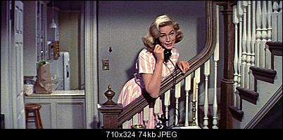

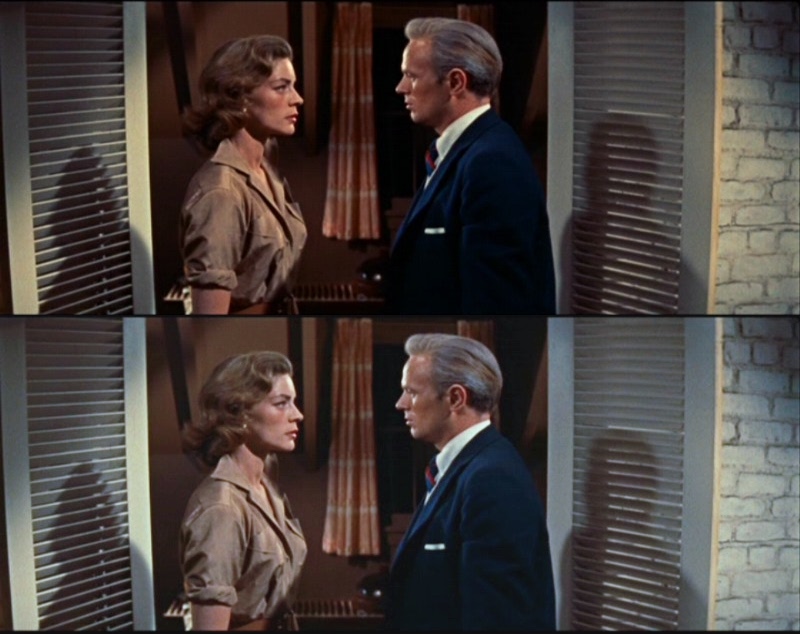

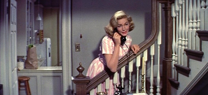

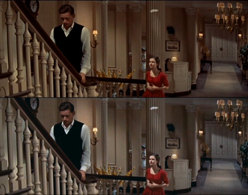

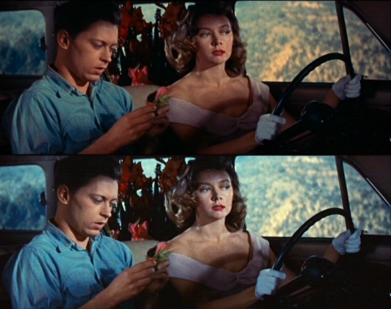

  1. The color of this movie seems quiet strange (a bit green or yellow, give me a kind of "old" and "outdated" feeling)
    I just want to make them into this kind of feeling, really lush color. Not very bright and not very dark. Also, not "old".
    Last edited by xuguang_he; 15th Apr 2013 at 09:11. Reason: The picture is not valid.

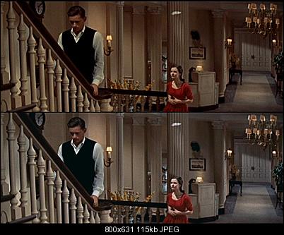

  2. I think he's referring to the overall grading , not the bleeding
    Anyways, the difference is what the colorist chose for this, and the biggest difference is increased saturation in the 2nd set of pics . So If you increase the saturation , it will come close probably to the look you want
    You can adjust the colors however you want , but your ability to do so will be limited compared to if you had what the original colorist had access to (you're working from a low quality dvd version, with low chroma resolution)

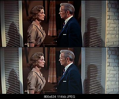

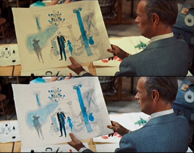

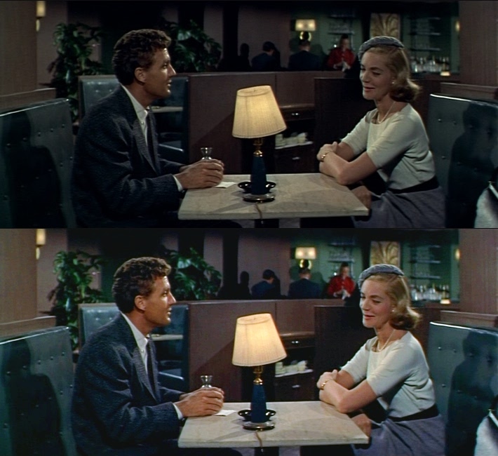

    Start by determining the white point and black point. It helps to keep luma and colors within 16-240 spec. I made some quick notes of problems to look for:
    Image 1: Too green. Blacks, grays, whites off-color. Undersaturated. Low gamma. Darks crushed.
    Image 2: Too green. Blacks, grays, whites off-color. Undersaturated. Low gamma.
    Image 3: Too green. Blacks, grays, whites off-color. Low Gamma. Darks crushed.
    Image 4: Too yellow. Blacks, grays, whites off-color. Low Gamma. Undersaturated
    Image 5: Too yellow. Undersaturated. Low gamma, brights suppressed.
    Image 6: Blue soppressed. Undersaturated. Low gamma.
    Image 7: Too green. Low gamma and contrast. Uneven color: darks and brights have different color balance.
    Image 8: Too green. Low gamma and contrast. Poor midtone/bright balance.
    Image 9: Too red. Oversauratd, darks crushed and corrupt, brights pushed and clipped. midtones suppressed. Grainy shadows.
    Image10: Oversaturated. Too red. Darks crushed, low gamma.
    Image 11: Too yellow. Low gamma, brights clipped.
    Image 12" Low gamma, darks crushed. Midtones too red, brights yellow, blacks red.
    Image 13: Oversaturated, highlights pushed. bright reds puhsed, midtonees green.
    Image 14: Oversturated. Too dark, reds puhsed, brights green. Grainy shadows.
    Image 15: Color completely corrupt, oversaturated, reds pushed, blacks blue and cruished, highlights clipped.
    4 sample corrections with gradation curves, Color Mill, Levels. Primary white-black points determined with After Effects.

    I made only one quick pass at these. A few gave me a lot of trouble. I tend to look for convincing color and levels. Sometimes it's just a matter of taste, but over saturation is usually a turnoff. To each his own.

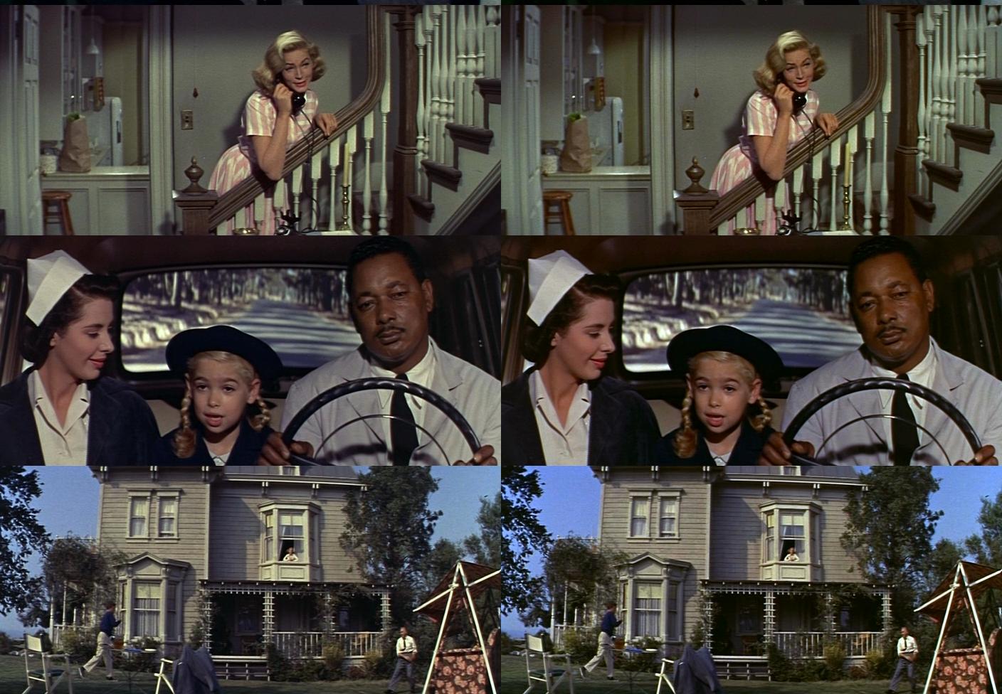

  8. Unless you plan to spend a month going through the movie scene by scene you'll probably want to do what poisondeathray suggested, crank up the saturation. Blues have faded because of the age of the print so you might adjust that a bit too. Something like:
    RgbAdjust(b=1.2, bb=-16)
    ConvertToYV12()
    Tweak(sat=1.2)
    before, after:

    In the above image, the black levels are too high, bright green and bright red are clipped, and the image is too green. It takes a while to pinpoint many problems, but most people get the idea. Learning to use histograms and pixel samplers also helps.
