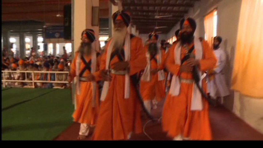

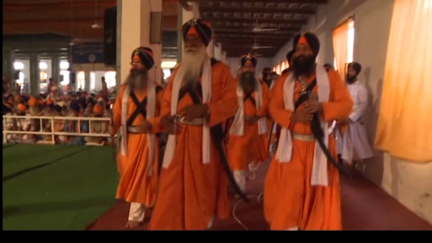

    I'm doing a video conversion from PAL to NTSC, and in the process I was noticing some artifacts and wondering what causes them. So take a look at the first photo, then the second. In the second there are some obvious "lines" that show up, for example at the edges of the scarfs that the men are wearing. Would someone tell me what the cause of this is? Thanks.

  2. It comes from improperly resizing interlaced material. Please search these forums for PAL to NTSC or vice versa, conversion is frequently unnecessary. What are you trying to accomplish?
  3. You have interlaced video (each frame contains two separate half pictures). Since some frames don't have comb artifacts and some do the video must be telecined film. I don't see any improper resizing but you also have a problem converting interlaced YV12 to RGB.
    Whether you should do anything about the interlaced video depends on what you plan to do with it. Make a DVD? Upload to Youtube? Etc.

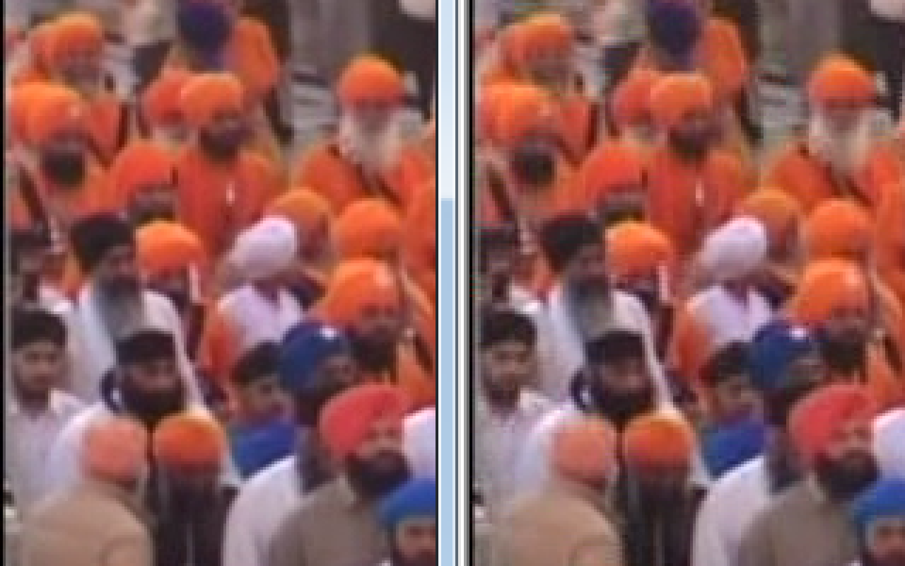

  19. Yes, as I suspected, MC duplicated every 5th frame (the camerawork in these shots is very jerky so it masks the jerkiness frame duplication creates), TMPG performed hard 3:2:3:2:2 pulldown. As manono suggested, encoding at 25 fps progressive and adding 3:2:3:2:2 pulldown flags will give better results.
    HcEnc 25 fps progressive + pulldown, TMPG interlaced hard pulldown (4x point resize)
    Click on the images a few times to see them full size. HcEnc file attached.
