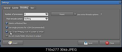

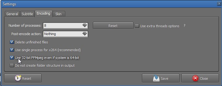

    Think I found a way to prevent the Codec ID : 00001000-0000-0020-8000-00AA00389B71 that causes problems with some players. In TEncoder under Edit -> Settings , Encoding tab. Check the Use 32bit FFMpeg box:
Name:	ScreenHunter_08 May. 31 10.50.jpg
    I used the 3.6.0.3730 version and it worked great! Have 6 channel AC3 with normal "Codec ID : ac-3".

  12. Member Budman1's Avatar
    Jul 2012
    NORTHWEST ILLINOIS, USA
    I use almost exclusively 32 bit versions of programs such as Virtualdub, tencoder, ffmpeg etc since I find sometime the codecs, filters, and other plugins are lacking for many 64 bit vdersions. I used 32 bit version Tencoder installed under Programs (x86) but I 'believe' FFMpeg_64 is still used unless you check the box under Edit -> Settings -> encoding tab to only use 32 bit FFmpeg.
    This is also verified by using the TEncoder's included FFMpeg direct and running the script created by Tencoder and producing an AC3 codec version of MP4. Not sure why yours didn't work...
