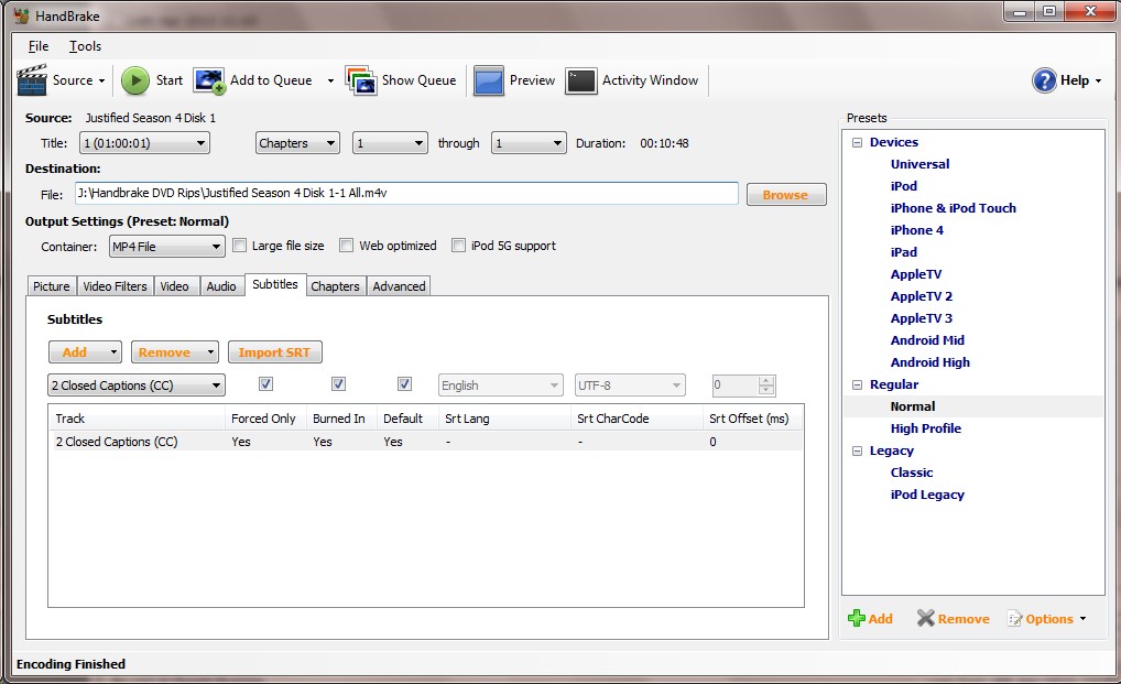

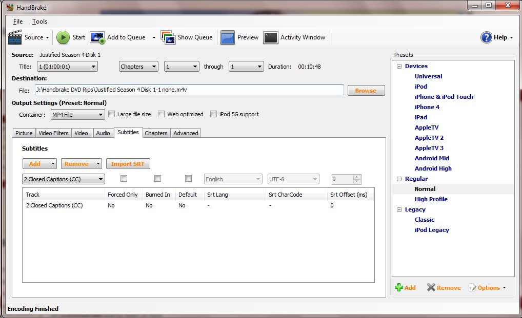

  8. I converted a test DVD to a mp4 file but the closed captions did not appear. I tried several different settings to no avail. Advice would be appreciated.

  9. Finally got HandBrake to work, converting closed captions to soft subtitles. See screenshot for settings that worked.
    My problem is solved; I can watch my recorded TV programs on my tablet with the captions displayed as subtitles.
    Thanks everybody, especially usually_quiet.

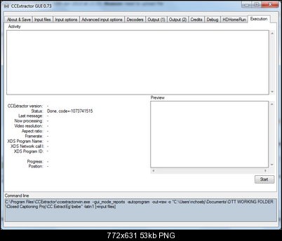

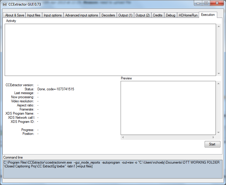

    I have CCExtractor 0.73 and struggling to extract the captions from a transport stream file ie .ts file. Status says Done with code 1073741515 but i get nothing on my output path. Please help??

    CCExtractor usually can't read the closed caption formats in videos that don't use the North American standard. Sorry.
