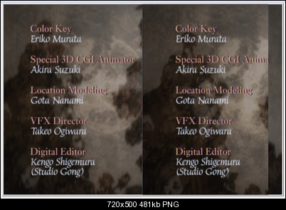

    I've choosen a relative thin font for a part of the credits.
    It was the only font where I could say, that it fits the context perfectly.
    I have choosen a relative small outline of only 4pixels with a light blue which makes it easier to read against the changing background and far easier to spot.
    In the preview of course it looks fine but in the lossless export I notice the color temperature has changed... so I feel nothing of the light blue outline which gave it a colder feeling and now it looks relatively uninspired.
    Is there a way to make Premiere render the font more strongly?
    I thank for every help and comment on this subject.

    Currently I'm using plain uncompressed UYVY 422 8bit.
    Only beacause I now have enough disk space for once ^^"
    the left one is still the vector in Premiere and the left one after export
    It's just natural tht it gets a little blurry but the color...

  4. The preview within premiere is full color RGB, unsubsampled.
    Your "lossless" export isn't lossless, it's subsampled 4:2:2. On thin color borders, the color is supposed to change, that's normal and expected because you have 1/2 the color resolution . It's only going to look worse when you deliver in a final format 4:2:0 for DVD or blu-ray (I'm guessing you're going to DVD
    Your only option is to use full RGB (that won't help you if you deliver in 4:2:0), or modify the text design

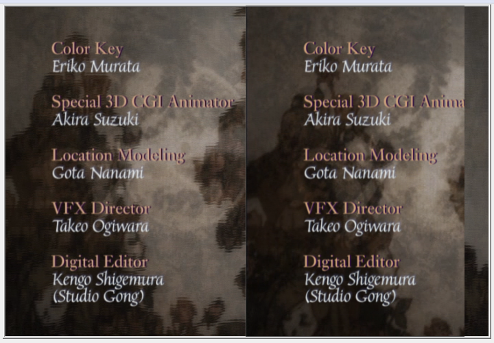

    I see interlace lines in both images, no wait, only on the left one. You put a gaussian blur? So that's why there's some artifacts on the right? And why do the images "wrap"?
    That blur changes the overall contrast probably.
    If you want the text sharp, you should add it separately as a composite layer.

    HMMM, that's weird. The one on the left is just the preview window in Premiere. The right one is the export.
    I didn't apply any blur.

    So you didn't deinterlace? Before render? I don't use Premiere, but shouldn't the preview be deinterlaced? You might have a bad source then.
    Something's wrong with your text overlay too. It's fuzzy. No way vector text is gonna be that fuzzy without a filter.

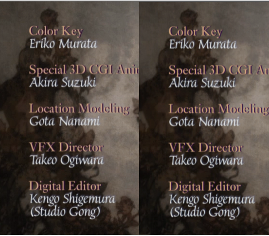

    I just did a little test render after changing the font size by 1.5 and 2pts.
    That's a result I can rather still accept, now I can see every little tail of the font.
    Still a difference but far better than before.
    right = export, left = PremiereClick image for larger version
