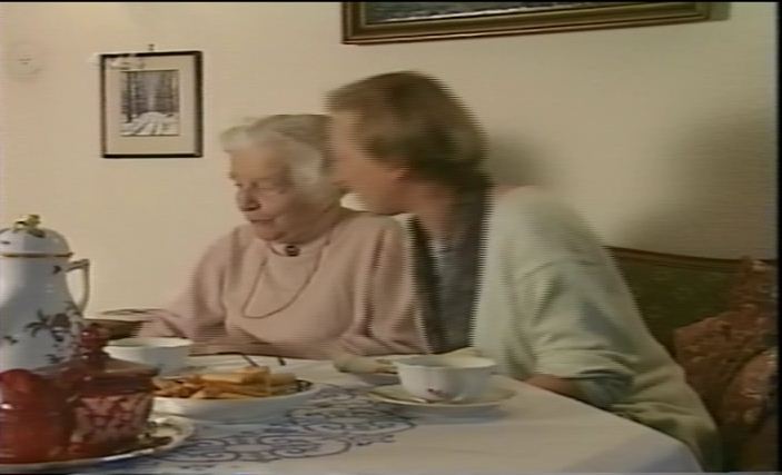

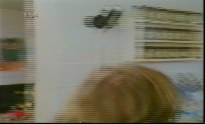

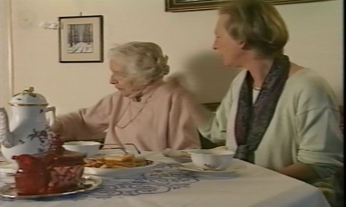

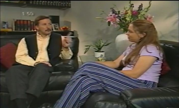

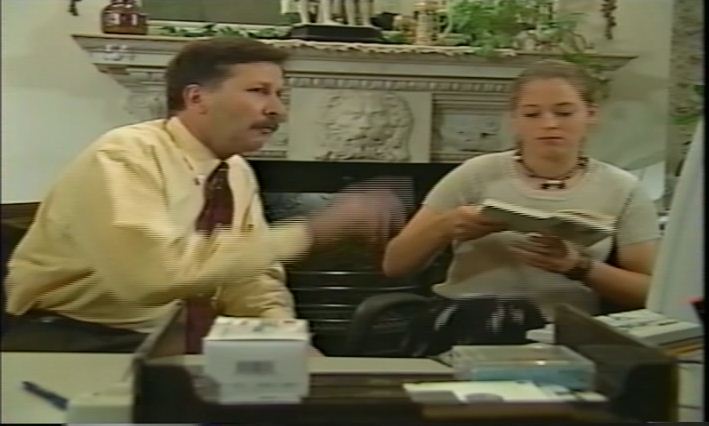

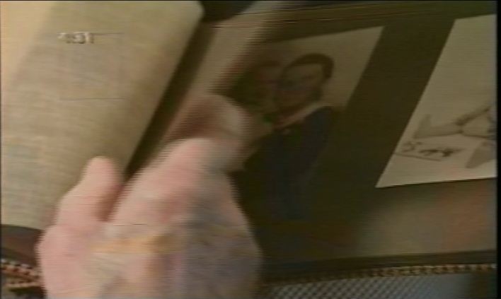

  8. O.K. I uploaded 2 clips of video and 6 clips of imagecaptured to show the fuzziness within the video. Please help with anysuggestions on fixing this problem.

  9. You captured an interlaced signal the resized the frame vertically without consideration that the frame was interlaced. This has caused the two fields to commingle. Capture at 720x480, burn to DVD at 720x480, 4:3 DAR.

    I suspect the software assume your source was 3:2 DAR since the frame size was 720x480 (a 3:2 ratio) and the AVI container doesn't really support aspect ratio flags. Within the software you used look for a way to override what the program thinks of the source aspect ratio. In many programs you right click on the video in the time line and select Properties, Source Properties, Aspect Ratio, or some such. Also look for a way to force the software to treat your video as interlaced, not progressive.
    Can you upload a short sample of your source video?
