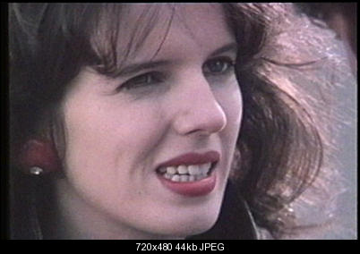

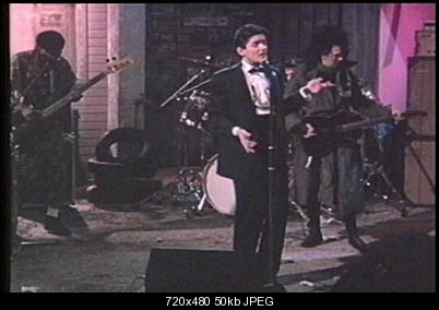

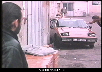

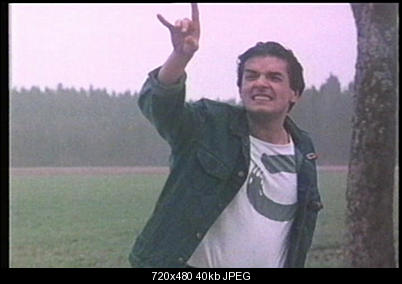

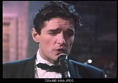

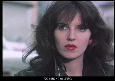

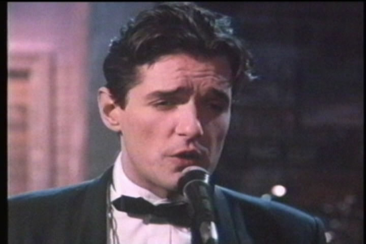

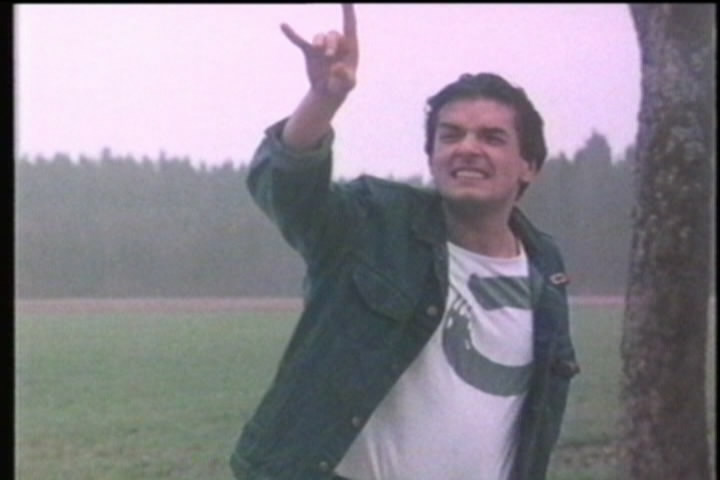

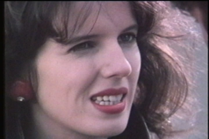

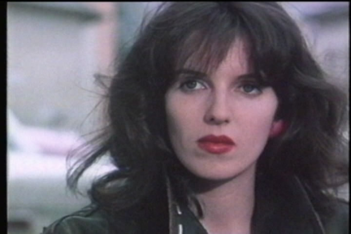

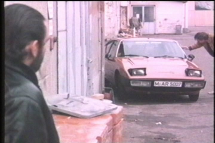

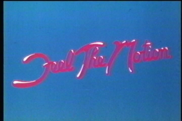

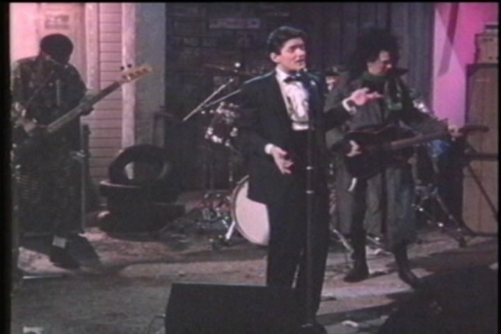

  9. Here are snapshots from final vhs to dvd. No software or hardware touch-up. Just ag1980. Captured via pinnacle. Codec dv avi.
    Dimensions: 720X480
ID:	17385Click image for larger version
ID:	17386Click image for larger version
ID:	17387Click image for larger version
ID:	17388Click image for larger version
ID:	17389Click image for larger version
ID:	17390Click image for larger version

  10. Originally Posted by vhsman View Post
    I take it you're not planning on burning it to a DVD5?
    What are we supposed to take away from all those pictures? That pink is your favorite color? When you said you'd post some results, I think everyone was expecting some actual video, not pictures.
  11. Banned
    New York, US
    We can't do much with stills, especially stills made with Pinnacle, converted to RGB using unknown matrices, and compressed with JPG. Apparently you have VOB's, which you can open with the free DGindex utility. DIGi9ndex has a prview screen that lets you edit a few seconds pof video and save it as an m2v. Several seconds of a scene with motion (someone walking or moving around in a room, for instance) would certainly be less than 100 MB in m2v, and can be posted here. Probably won't need audio for now.
    Quickie judgment from the stills....well, no, anything from stills would be a guess. All that the images show are serious color, contrast. and definition issues whose causes are yet to be determined. The images look almost like colorized b&w. Lots of analog noise. But without a chunk of video from the VOB that gave you these pictures, that's all one could say...and even that could be wrong because we don't know how you converted your source's colors to get the pics.
