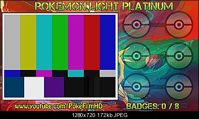

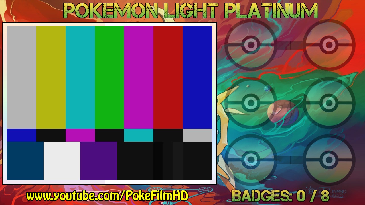

    hello guys
    is there any way that i can put any video on the silver section in this pictures?

    pip=colorbars(width=720, height=540)
    background=ImageSource("vg0f9v.jpg.png")
    overlay(background, pip, x=24, y=92)

    [Attachment 17182 - Click to enlarge]

    image like this one but im gonna remove the white background
  19. So it's a single image , not a sequence then ?
    Just remove the white brackground (mask it out, or key it out) save it as a transparent png (RGB32), and follow the example above in post #17. As before, you have to adjust the x, y parameters and so forth
