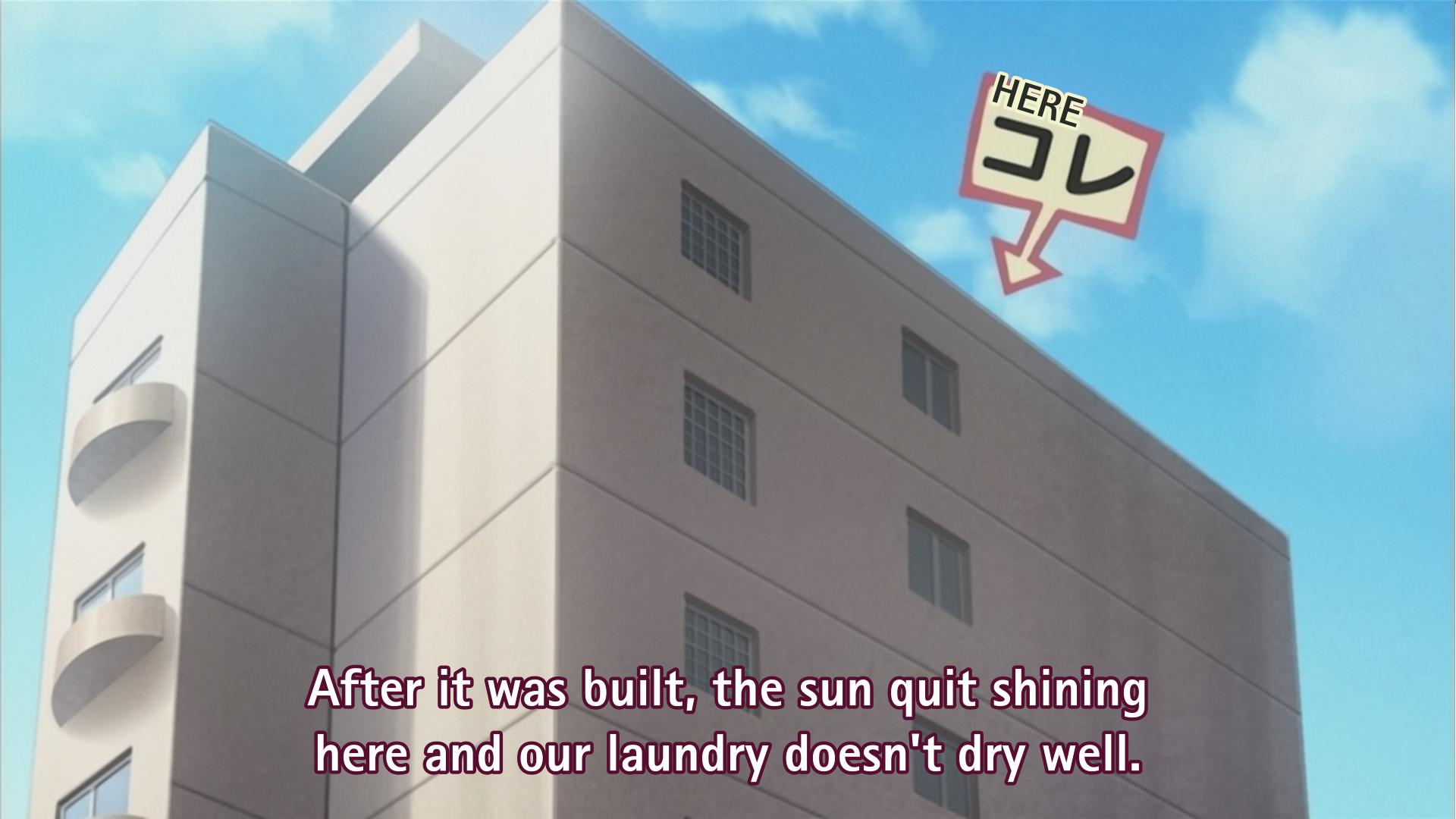

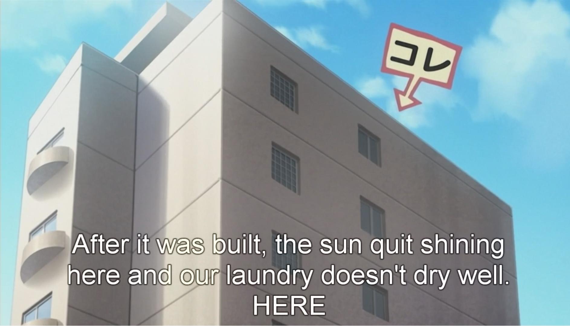

  3. I just want the subtitles to look like the source stuff does.
    For example: what I currently am having to watch on my ipod is this https://forum.videohelp.com/images/imgfiles/pVvWGVJ.jpg (In this scene they don't look transparent, but they are.
    I'd much rather have subtitles that are not transparent, and where the subtitles stay in the same place. Like this: https://forum.videohelp.com/images/imgfiles/xREtlT3.jpg
    I think this clearly demonstrates what I want. Is there any way to do this?
    Also, it seems with some of the shows I have, the subtitles DO stay in position, but they are much more transparent. I guess the first subtitles could be considered Translucent...but nobody really makes that comparison...I think.
