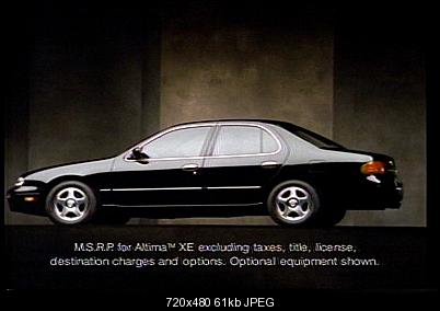

    ... and ghosting and rainbowing/dot crawl, which aren't as notable to me.
    No lossless capture available; my friend's recording is "only" MPEG-2 9.2Mbps CBR. I'd like to improve the DVD a little if I can. Ideas?

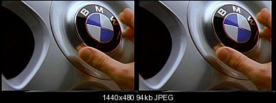

    Before, after:

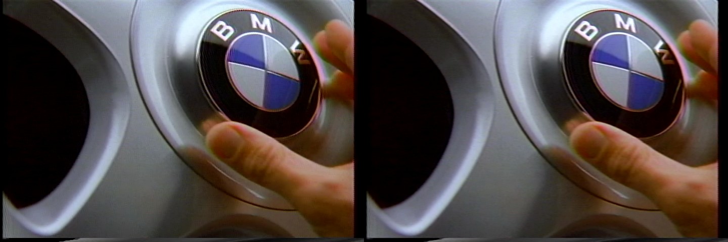

    Noit having much luck with eedi2, but I don't know it that well. TIVTC removed most of the worst of the "bursts" of jaggies, leaving 3 frames that have this effect, which I cleaned up a bit with ReplceFramesMC2. Diagonals look smoother, mainly because the ReplaceFrames softened things a bit (the effect was in 2 consecutive frames, and the camera is panning toward the left).
    After TIVTC (left), then TIVTC with RemoveFramesMC2 (right). But jaggies are still on diagonals, and this is not a really good fix for the whole video.
    [Attachment 17170 - Click to enlarge]

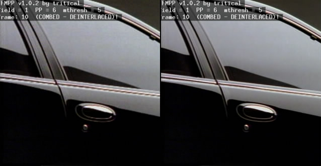

    pdr's right. Most of the clip is field-matched with no use of QTGMC. But rather than use the built-in TDeint when TFM doesn't field-match, it uses QTGMC as the deinterlacer. You can put on 'Display=True' to see when it's being deinterlaced. Here it is at default settings and using QTGMC. On the left is:
    TFM(Display=True)
    Tdecimate()
    On the right is:
    Deint = QTGMC().SelectEven
    TFM(clip2=Deint,Display=True)
    Tdecimate()
