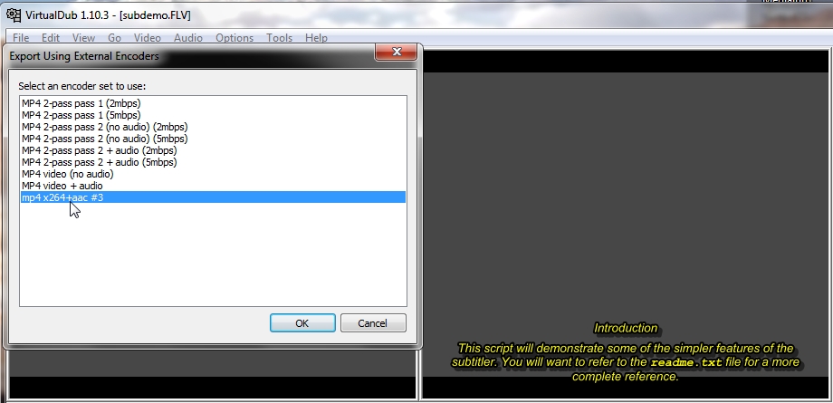

    Baldrick pointed out perfectly that Virtualdub works best for ASS and SSA subtitles when used with the VSFilter (textsub) and can now use external encoders to save directly to MP4 and MPEG-2 formats. If you wish to set it up an excellent link is at
    http://frapsforum.com/threads/virtualdub-save-direct-to-mp4-fraps-to-youtube-with-external-encoders.2446/ to set an initial MP4 encoder and additional types can be set up with the 2nd post links at http://forum.timescapes.org/phpBB3/viewtopic.php?f=4&t=716&start=20.

    Update: Sambat also posted a couple excellent links on external encoding with Virtualdub in this https://forum.videohelp.com/threads/355062-VirtualDub-MPEG-2-MPEG-4-saving?p=2232636 post that link to:
    http://forums.virtualdub.org/index.p...T&f=3&t=18840&
    Two thirds down this thread, a short how-to.
    http://forum.timescapes.org/phpBB3/v....php?f=4&t=716
