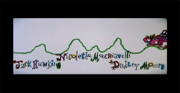

    I have a video file which does not fill the screen. There is a screen grab below, can anyone advise on how I can re-size it?
    The MediaInfo report is also below.

  2. Member Cornucopia's Avatar
    So that file you have is badly encoded. Clearly, it was taken from a DVD rip, but when re-encoded, it should have either been encoded to the same dimensions and kept the same Display AR (either 4:3 or 16:9, NOT 3:2) or it should have been resized to dimensions that compensate for the change to a more popular 1:1 Pixel AR (for example, 852x480 with 16:9 DAR).
    However, my guess is that even then you would still have letterboxing/pillarboxing, because I believe it is burned into the picture.
    Thus, you could crop top+bottom (or left+right if that's how it was encoded) and resize the remaining picture to a 1:1 PAR. That would likely play more accurately in your media player+TV combination.
    That's a lot of work. You may instead want to just use the ZOOM control on your TV.

    Thanks, you could be right Scott. Letterboxing I can put up with, but when its accompanied by pillerboxing, nope.

  9. Originally Posted by captainzog View Post
    region 1 copy, in the UK, in fact, in the next city, for £3.99 inc delivery. I shall rip it to my media server and enjoy it with my grandchildren.
    Just hope it's not a 2.35:1 movie letterboxed in a 4:3 DAR frame. If it is, you'll see the exact same letterbox+pillarbox on your TV.

  11. Member budwzr's Avatar
    Apr 2007
    City Of Angels
    Interesting that the corners are darkened typical of a lens shadow, or vignetting. They filmed it.
