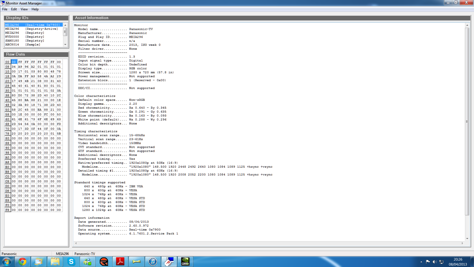

    I had a look on Nvidia`s site and they mention a tool to check the tv/monitor signal.
    I ran it and it showed my screen size as a 1280 x 720!
    Here is are the results:

    This would indicate an Overscan problem wouldnt it?

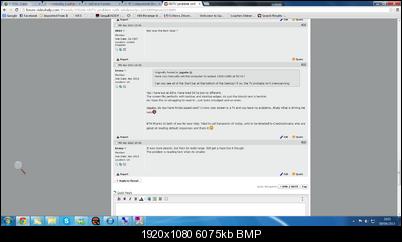

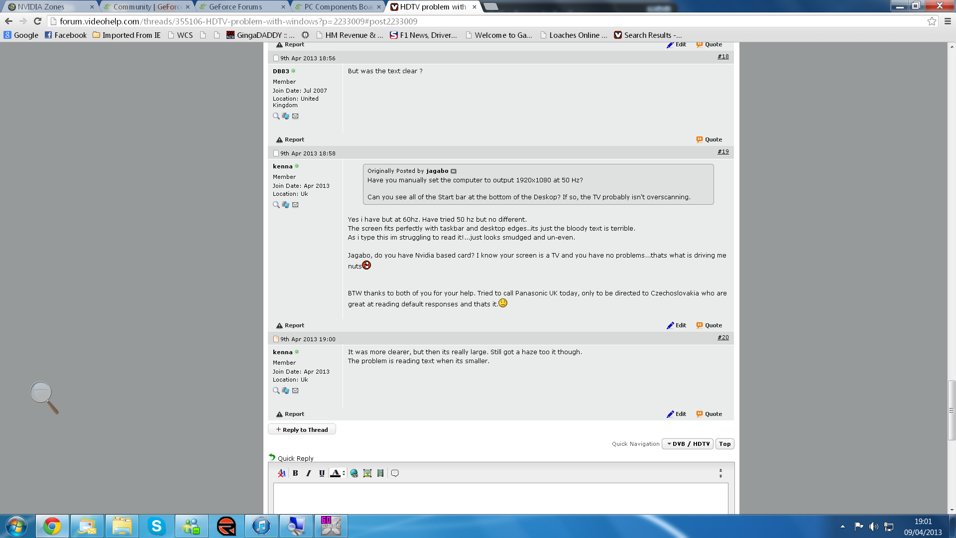

  21. Ill try and post a pic
  22. im hoping you can see my issue, although it may look fine on your Monitor/Tv.
    If you look at the text it looks crappy

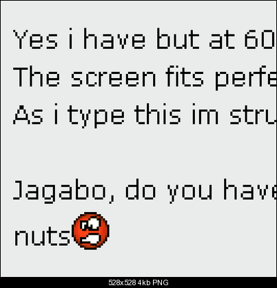

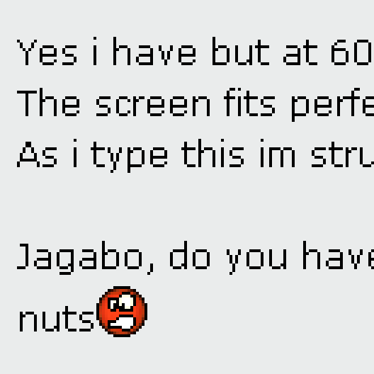

  24. Originally Posted by kenna View Post
    The screen fits perfectly with taskbar and desktop edges..
    Then it doesn't sound like an overscan issue.
    Jagabo, do you have Nvidia based card?
    It's currently an ATI card . But I've had Nvidia cards in the past with no problems.
    Your image looks fine here. Perfectly sharp text. 4x point enlargement:
    Make sure your computer is putting out RGB, not YPbPr.

    You need to use a digital camera and take a picture of the tv screen. What you posted is a "print screen" of your desktop.
  29. Originally Posted by Khaver View Post
    Yes, but the BMP confirms the computer was running at 1920x1080 and the text was rendered sharply.
