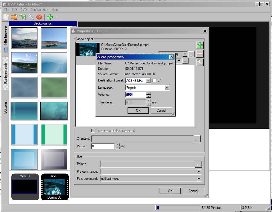

  2. If what you want is a video DVD DVDStyler has an option for adjusting audio volume
  3. Thanks for the recommendation. That software seems very good.
    ConvertXToDVD is also very good imho, it's a pity though it lacks such a basic feature.
    Also, do you have any idea if the volume value is consistent with video players, so for example I can use VLC to 'level' them and use the same values in that software?
