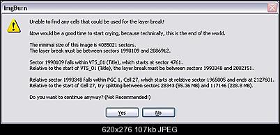

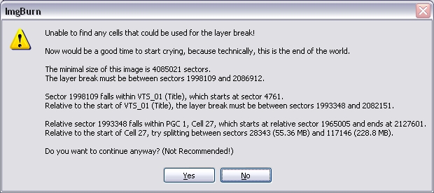

  18. Well, I tried to burn another file, a bigger one and this time I got an error.
  19. Member [_chef_]'s Avatar
    Nov 2002
    Germany
    That's no error, just an info with suggestion!
