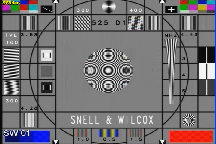

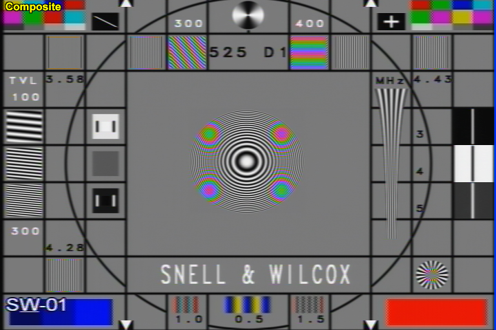

    Are you using S-Video input into the Kogan thing? It's probably the same chipset as the EasyCap, which has godawful composite quality and perfectly fine S-Video.

    I connected it to the camera with the AV cables although there is a seperate S-Video connector (if I had a male to male lead to hook it in to the camera). The unit looks a lot like the EasyCap you mention. Kogan doesn't actually make anything- it's all 're-badged' product so it might well come out of the same factory as the EasyCap. You think it's worth finding the S-Video link and trying that?

    Yep. An S-Video cable is useful to have around anyway. Here is my quick comparison using cables from the local dollar store.

    (The bad Y/C interference seen on the S-Video capture probably isn't the fault of the device but rather a poorly shielded cable, as using the ATI 600 with the same input looks almost as bad.)

    Thanks for the advice- yes quite a difference between the 2. I'll get myself an S-Video cable and let you know how I get on.
