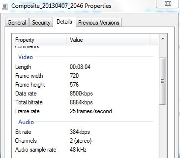

    and I am using it to capture from VHSs and Mini DV and I would like to capture in the same quality as the VHS / Mini DV recordings.
    I have taken advice a long time ago using my setup for capturing and it seems to work fine.
    My capture card is a Hauppage HVR-1300 and I am using WinTV v7 as the capture software (nothing else seems to work with the HVR-1300) everything in WinTV is default except that I have setup advanced settings to Auto Convert MPEG-2 Recordings to .mpg.
    I have also enabled 3rd Part Decoders (not sure why I have done this) and it is using MainConcept (HCW) MPEG-2 Video for MPEG-2 Video and Hauppauge MPEG Layer-1/2 Audio for MPEG1 Audio.
    With these settings an 8 min capture is 456MB!!!
    The clip details are shown in the attached screen shot but are as follows:
    VIDEO
    Length: 00:08:04
    Frame Width: 720
    Frame Height: 576
    Data Rate: 8500Kbps
    Total Bitrate: 8884Kbps
    Frame Rate: 25 frames/second
    AUDIO
    Bit rate: 384Kbps
    Channels: 2 (Stereo)
    Audio Sample Rate: 48Khz
    If I change the decoders would I get better compression? If so what would you recommend that would work with this capture card?
    Many thanks
    Image Attached Images
  2. You've already lost considerable quality by capturing to MPEG. You'll lose more quality by reencoding at a lower bitrate. You may or may not notice the difference.
    That's not a lot. Try capping lossless sometime. I don't know the card and don't know if it has settings to capture at a lower bitrate. If it does, use that. If it doesn't, the only way to get a smaller size is to reencode at a lower bitrate. You may want to filter it to remove noise and fix colors and/or other things. If so, you should cap at the highest bitrate it allows and then reencode to the final bitrate at the same time fixing what needs fixing.

    The decoders used by WinTV 7 won't have any effect on the size of your video. They don't play any part in encoding the video. They are used only for displaying the video and audio. The hardware encoder's settings alone determine the filesize. To decrease the file size, you will have to reduce the bitrate by using a lower quality setting in WinTV v7. The quality of the capture will be lower too, but that is unavoidable if you want smaller capture files.
